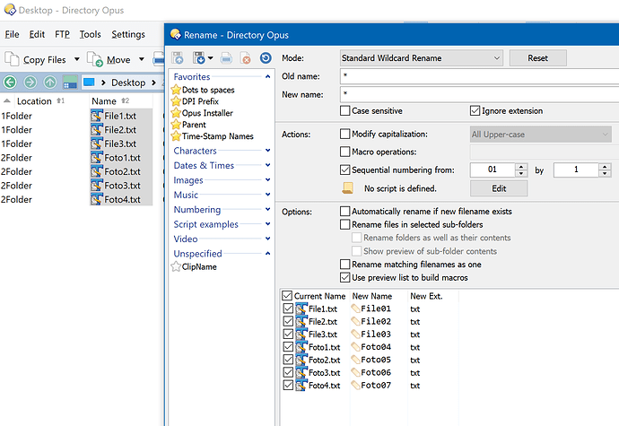

Flat view does show everything correctly.
But when I select the files and click the rename button the files show in a different order. Perhaps by age
Currently it looks like this.
1folder
file01
file02
file03
2folder
foto1
foto2
foto3
foto4
When I do flat view I see the correct order

If I open the rename window the not yet renamed files
foto1
foto2
foto3
foto4
file01
file02
file03
They should go into the Rename dialog in the same order they are in the file display:
Found the solution.
The files always displayed correctly in the lister.
But this time I sorted them using the location column.
It looks the same, in the lister but in the rename window it's as it should be.
Perfectly renamed now! Thanks Leo!

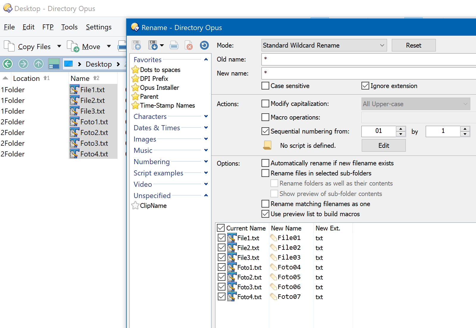

Now I've some cleaning up to do in the rename window.
Simple stuff I always did by selecting whole columns by dragging my mouse.
That no longer seems to work. It only selects the file my mouse pointer is over.
Likely I changed a setting. But which one....?
Make sure Use preview list to build macros is turned on.
YEAH!
Thanks Jon!
