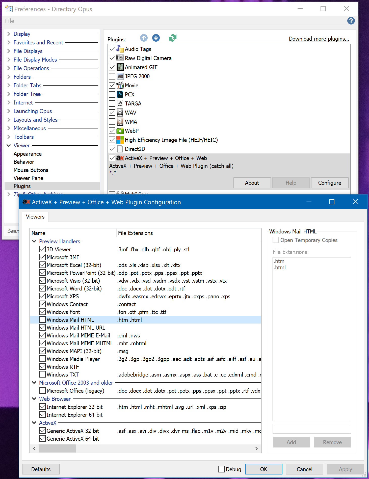

I am using 12.10.5 and have problems when I preview a html file. It usually hangs when I click on the file (sometimes it shows, but clicking on the preview causes the same problem) scroll down) and I have to kill DOpus. I don't know if this is due to using a 32bit Version of Internet Explorer (dOpus is 64bit and Windows 10 too) as it shows Internet Explorer 32bit in the top bar.

32-bit IE is the norm, so don't worry about that detail.
If you open IE (make sure it is IE and not Edge) and drop the same file on it, does it also freeze there?
Either way, if IE is freezing in the viewer pane, you could try enabling the Windows Mail HTML viewer instead, to see if it works better on your system:
Hi Leo
Thanks, that solved the issue! (although, the html-previews are not so nice as before when the internet-explorer viewer worked).
