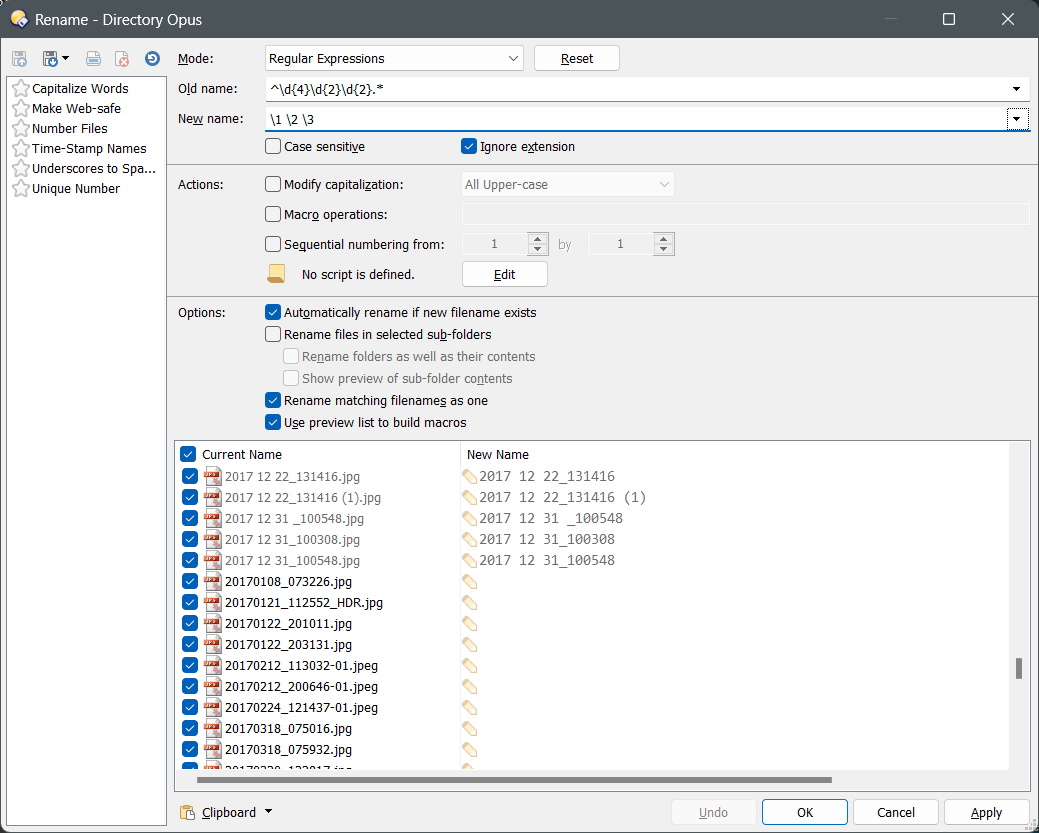

I already try this Regular Expression and it worked filtering: ^\d{4}\d{2}\d{2}.*
But what I need to add to the New Name?
This is my current work:
Your regex needs to include (...) around the things you want to capture for the \1, \2, etc. in the new name to insert anything:
Old Name: ^(\d{4})(\d{2})(\d{2}).*
But, since you're just inserting spaces at fixed positions, you can do this in an easier way without regex:
  • Make sure only the files you want to change are selected (not the extra five at the top of the list in your screenshot).
  • Ensure "Use preview list to build macros" is on. (It's already on in your screenshot.)
  • In the preview list at the bottom of the Rename window, click the first file in the New Name column.
  • Edit the name. Your edits will be applied to all the other names as well.
