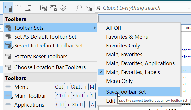

Just drag if back, then turn on the lock so you can’t drag them by accident.
You can also save a Toolbar Set to let you restore the arrangement you want.
And you can turn off automatic saving when the window is closed, so that any accidents can be undone by simply closing the window and opening a new one.
Can’t see how this could be improved beyond what’s there already.
easy to restore if you have a bunch of saved favorite sets
although you cannot assign a global hotkey to Toolbar LIST=sets so you would need at least one toolbar visible with the button on it to restore a set.
That's what i usually try. But once it was going wrong, there is no good way to drag it back.
Sounds good. But where is that setting? And also thanks for the tip with saving the toolbars separately. I almost never used that before. Instead, i mostly do full backups. Still would appreciate some improvement, it is very delicate with toolbar arranging.
Thanks. My old problem, i don't have all those default menues in my configuration. So i can't find that menu you are showing.
Preferences / Layouts and Styles / Default Lister / Update Default Lister automatically when closing a Lister

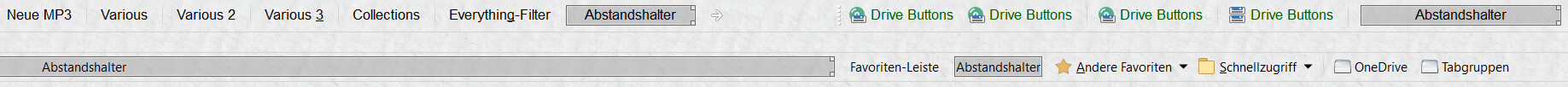

Well, actually it happened when i was adding or modifying a very wide separator element. That is the way i achieve the placement over the middle separator. But that was only a special case. I don't rearrange toolbars very often, but when i do, it is always a very delicate action. The image below shows my current placement of the favs bar, which i found to be more convenient placed at the right side.
