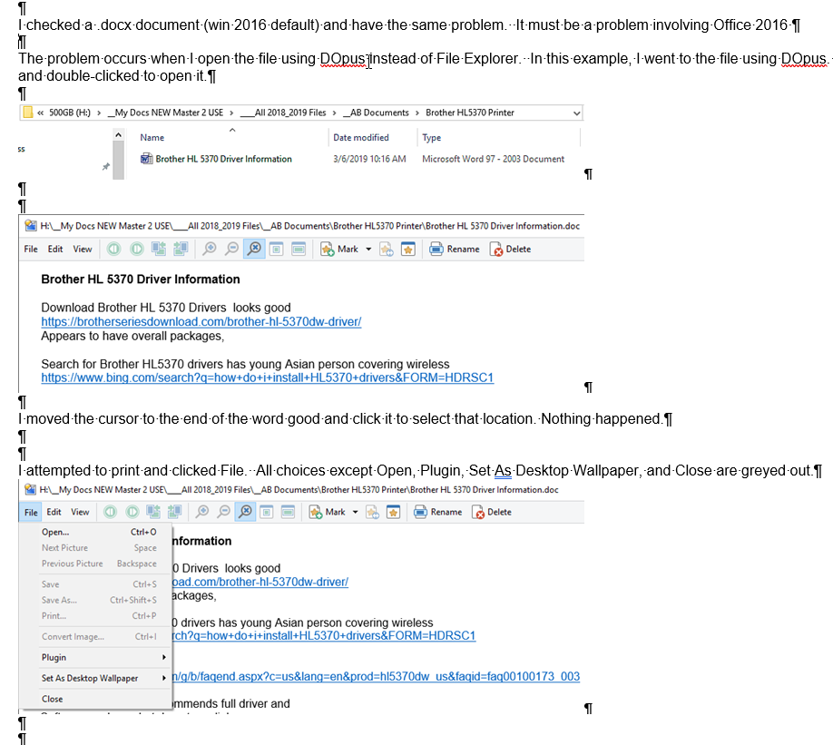

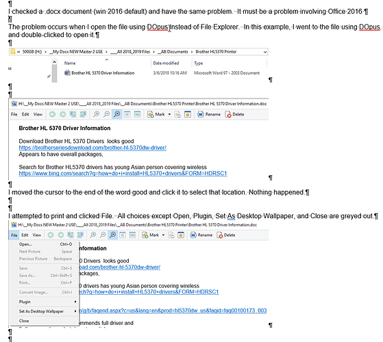

Images were made using IrfanView. If they are not seen, what should I use?.
I checked a .docx document (which is used by default) and have the same problem. It must be a problem involving Office 2016
The problem occurs when I open the file using DOpus instead of File Explorer. In this example, I went to the file using DOpus. and double-clicked to open it.
I moved the cursor to the end of the word good and click it to select that location. Nothing happened.
I attempted to print and clicked File. All choices except Open, Plugin, Set As Desktop Wallpaper, and Close are greyed out.

Double-clicking Word Documents would not usually open them in the Opus viewer. You must have done something to cause Opus to open them on double-click - did you add the .doc suffix to the Images File Type Group, for example? Or use Open With... to associate them with the Opus viewer?
While Opus can show them if you have the correct preview handlers or ActiveX viewers installed, you would normally want double-clicking a word doc to open it in Word, as the viewer is not a full replacement for Microsoft Word.
That must be the problem. On this computer, there is an Opus icon at the upper left corner of a Word document, while a Word icon appears when using another computer. I assumed Opus added it on the latest upgrade.
