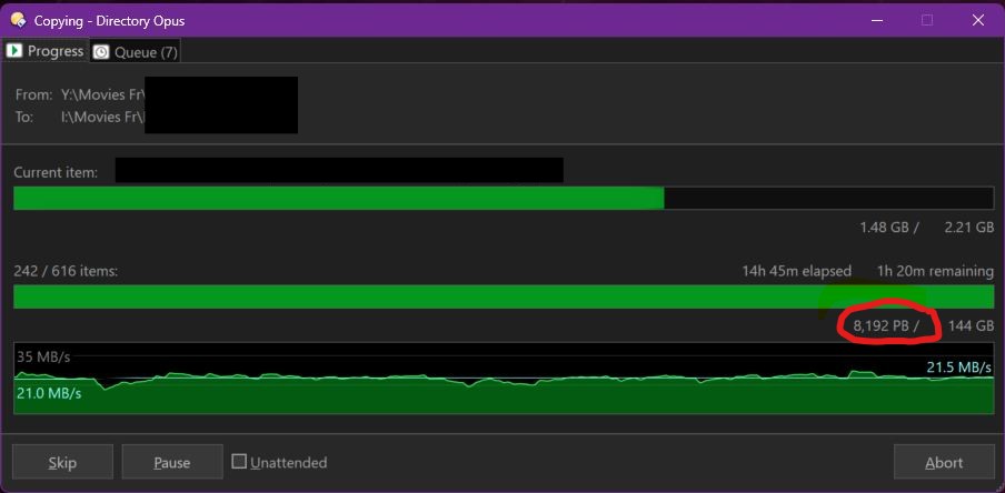

Hello if the progress bar is interrupted by an error while copying a lot of files for few hours. The cumulative size of the items goes to 8192 PB. I saw it several time, whatever the copying error.

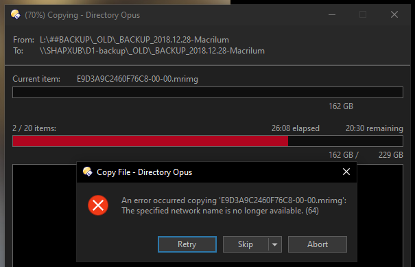

In my case it looked like this.

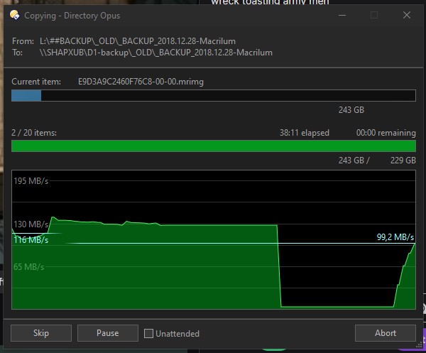

And occasionally resulted in this.
Felt that on Retry current copied amount was messed up, but not exactly instantly. I got few of these errors.

I've also seen this. Probably not helping much, everything's a little hazy since I wasn't really paying attention. It happened when I was busy with other stuff and barely noticed what happened until it had already happened. Let me try and remember, and know that I might not remember everything correctly.
I managed to disconnect a USB cable during the movement of some larger files from a DJI Mic. The cable was disconnected while moving the final, or last to final, file. DOpus showed a regular 'no longer available' notice and I connected the USB cable again. I think it then showed 8192 PB, right after the cable connected again and the file move continued, then went back to showing the normal size after a second or two, before the file move finished.
v13.22
I dont really remember the error message, something about device error (it's a 1TB sdcard) . I just resumed mechanically after the error sat there for more than 8h while i was at work.
