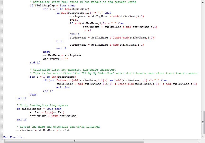

Add this to the TitleCase script near the end, as shown in the screenshot below:
' Capitalise first non-numeric, non-space character. ' This is for music files like "07 By My Side.flac" which don't have a dash after their track numbers. For i = 1 to len(strNewName) if (not IsNumeric(mid(strNewName,i,1))) and mid(strNewName,i,1) <> " " then strNewName = mid(strNewName,1,i-1) & Ucase(mid(strNewName,i,1)) & mid(strNewName,i+1) exit for end if Next
Awesome. That worked perfectly.
Thanks Leo. I've now added this code to the Titlecase script permanently. It can be re-downloaded from the Titlecase Script topic.
