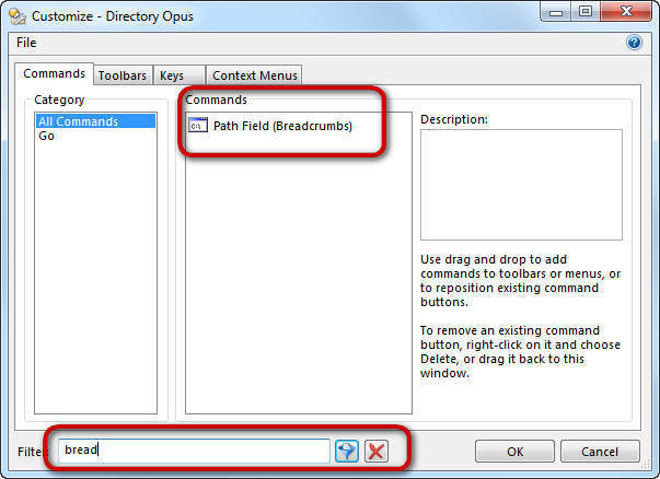

Sounds like you mean the path location bread crumbs field. To add that to a toolbar, put Opus in customize mode, then in the Commands section of the dialog, type bread in the filter field and you should see Path Field as shown in the below screen grab. Drag that to your toolbar, exit customize mode, and you should have it.

Thanks - that's what I was looking for. It used to be at the bottom, below the files listing, where there is now just the name of the current folder. But having it on top, in one of my toolbars is just fine.
And, I dragged it out to be able to display very long paths.
If I had know it was called "breadcrumbs", I could have found it in HELP. But I did not know that was its name - but I do know.

If you have something showing the name of the current folder at the bottom, that must be a toolbar, I think, so you could probably drag the breadcrumbs location bar there if you wanted to. Or maybe you want to get rid of that toolbar since I'd think it would now be redundant if all it does is show the name of the current folder.
Right Click on opus tool bar\customize\commands\all commands\Path Field (Breadcrumbs). Drag it onto Opus and size to your liking.
Displays current path and lets you select anywhere on the path.
I agree it is one of the great ones in Opus.
Bob
You can also right-click it and choose the full width option to make it fill any unused space in the toolbar, which is usually good for path fields.
