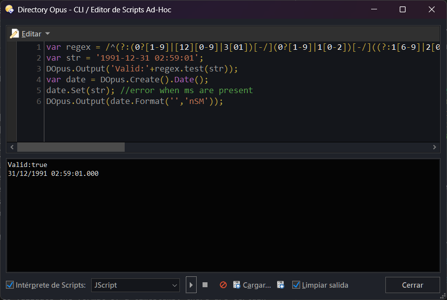

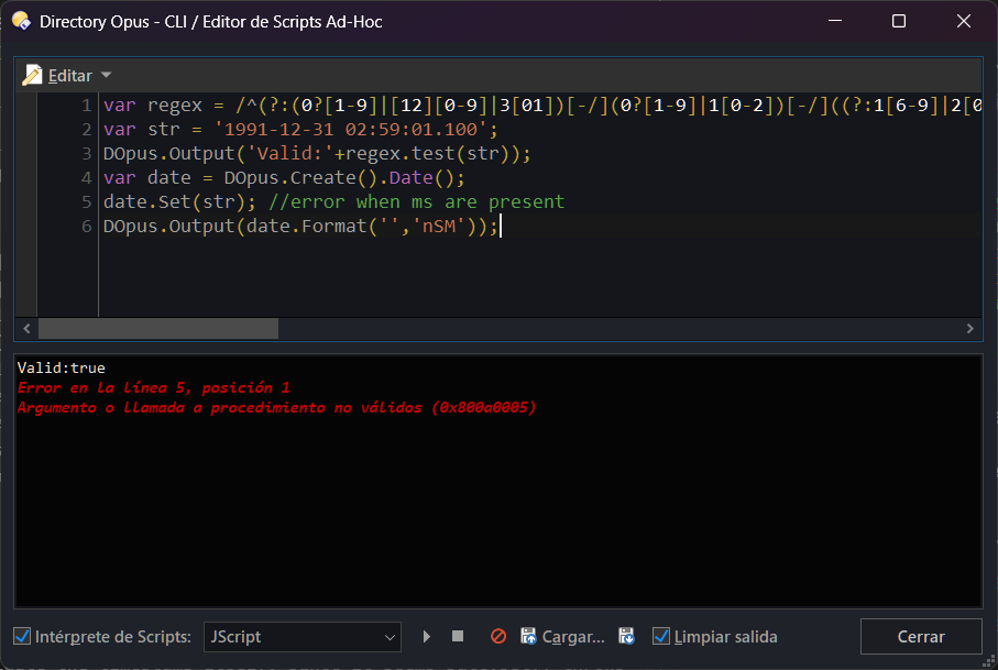

  1. According to the manual, you can set a date using Date.Set() with a string like yyyy-mm-dd hh:mm:ss.mmm. But it seems Set() doesn't like milliseconds.
    e.g.
var regex = /^(?:(0?[1-9]|[12][0-9]|3[01])[-/](0?[1-9]|1[0-2])[-/]((?:1[6-9]|2[0-9])\d{2})(?:\s(0?\d|1\d|2[0-3]):([0-5]?\d)(?::([0-5]?\d)(?:\.(\d{1,3}))?)?)?|((?:1[6-9]|2[0-9])\d{2})[-/](0?[1-9]|1[0-2])[-/](0?[1-9]|[12][0-9]|3[01])(?:\s(0?\d|1\d|2[0-3]):([0-5]?\d)(?::([0-5]?\d)(?:\.(\d{1,3}))?)?)?)$/;
var str = '1991-12-31 02:59:01.100';
DOpus.Output('Valid:'+regex.test(str));
var date = DOpus.Create().Date();
date.Set(str); //error when ms are present
DOpus.Output(date.Format('','nSM'));
Without milliseconds it works fine.

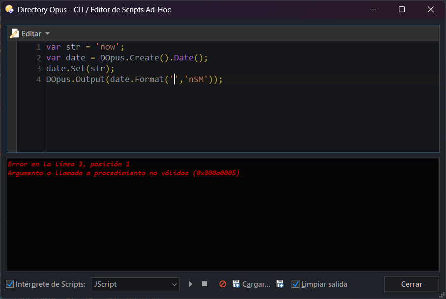

The string 'now' is not working either.
Fixed in the next beta.
