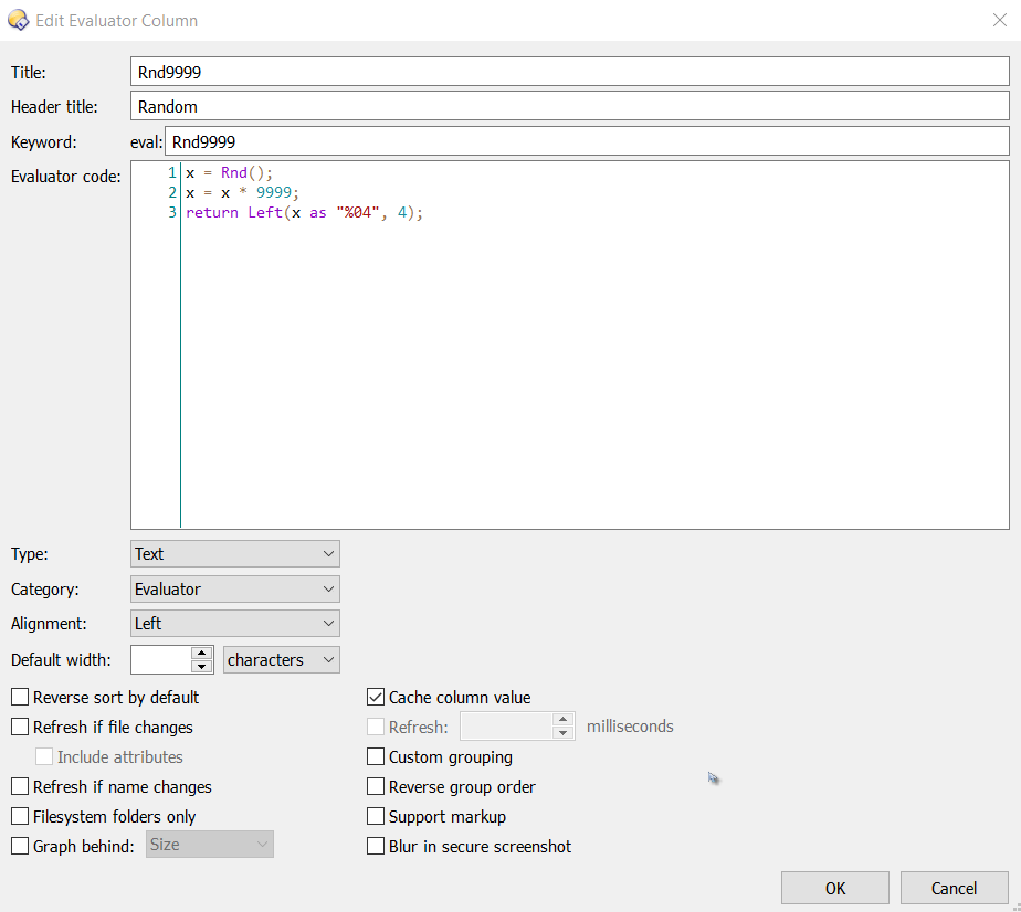

  1. You need to make an Evaluator Column that generates the desired random numbers. I made this one.
Here is the code that you can paste into the Evaluator Column GUI in Preferences.
<?xml version="1.0"?>
<evalcolumn align="0" attrrefresh="no" autorefresh="no" blurrable="no" customgrouping="no" foldertype="all" header="Rnd9999" keyword="Rnd" maxstars="5" namerefresh="no" nocache="no" reversegroups="no" reversesort="no" supportmarkup="no" title="Rnd9999" type="0">x = Rnd();
x = x * 9999;
return Left(x as &quot;%04&quot;, 4);</evalcolumn>

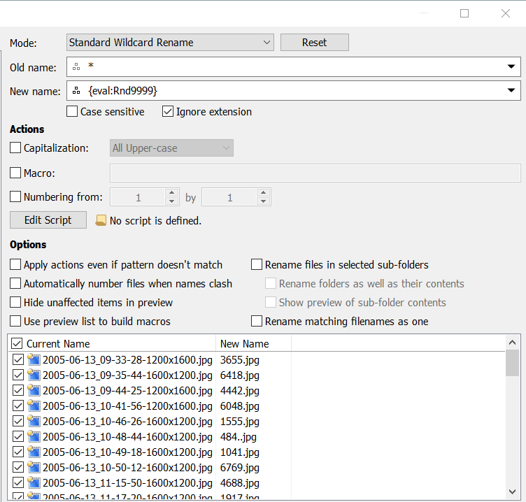

  1. In the Advanced Rename GUI add this preset.
Here is the actual preset.
Rnd9999.orp (193 Bytes)
