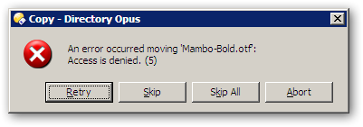

Can you post a screenshot of the error message you're seeing? Just attach it to a reply using the PostReply button (not the QuickReply area).
Here's the error...
I don't think that's due to the read-only flag.
Do you have permission to move the files in that folder? Does the same move using Explorer work?

Yes, I have permissions to move files.
In Explorer, I get a warning that the file is RO asking me if I want to move it.
If I push "Retry", it simply returns to this error window.
And if I deselect the RO flag... Dopus moves the file just fine.
