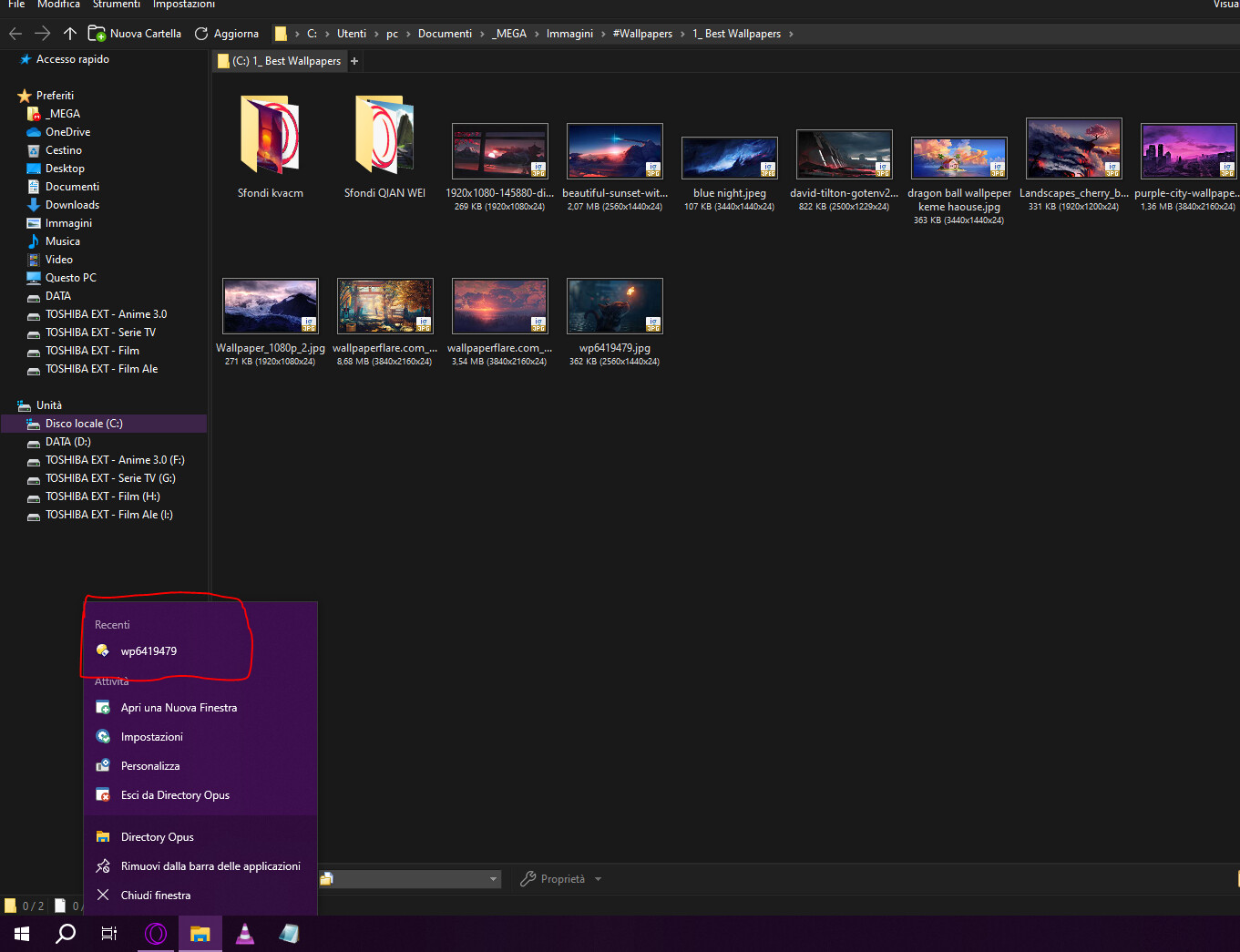

The thing i would like to "fix" as shown in the screen below:

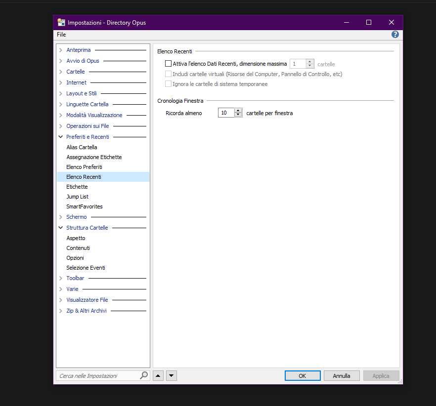

I have in my setting, recently set the recent history to remember 20 folders, and the recent list to off, this because i need to go back to previous folders a lot, but i don't want the recent files to be shown when i right click on the icon. Is there a way to "fix" this?

I've set everything off, but still the recent files are shown...

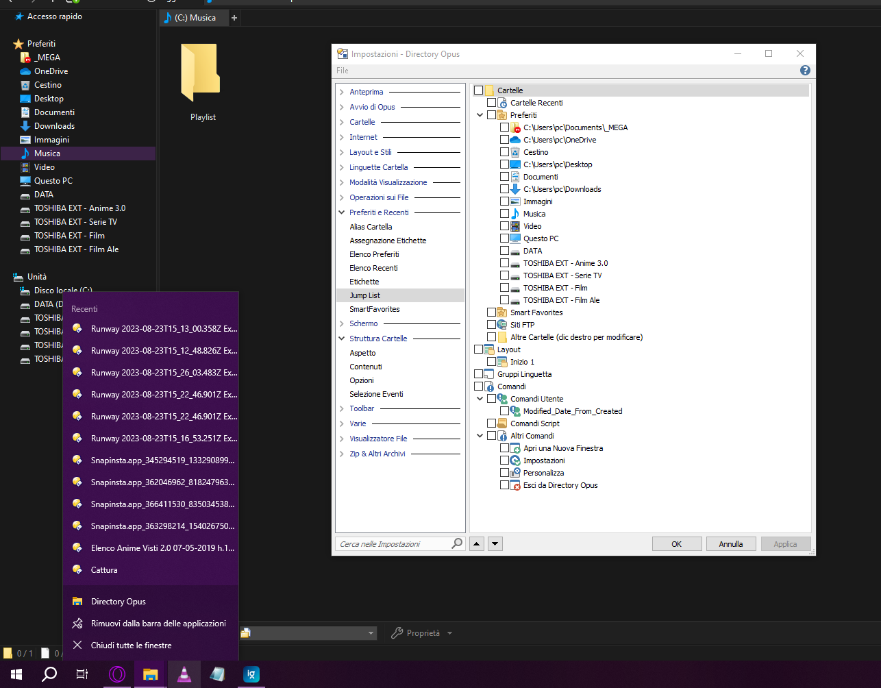

Here is the screen of the jump list settings and how it looks:
While here is a screen of the Recent list and history:

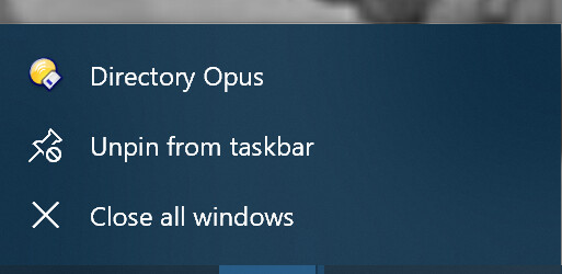

Strange; when I do the same, I get a blank menu, aside from the things Windows adds itself:
If you turn on the commands at the bottom of the settings list, does that make a difference? It's possible Windows (or something) is adding the folders when the menu is empty, or not full enough. I've never seen Windows do that with Opus before though.
If i turn on the commands it does the same thing

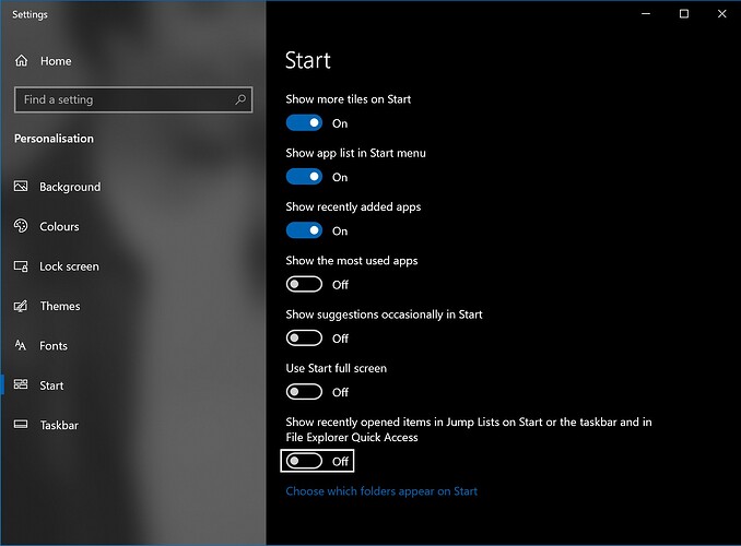

Does toggling the bottom option, for recent items, in Windows Settings > Start make a difference?
Yes thanks, now it doesn't show recent files
