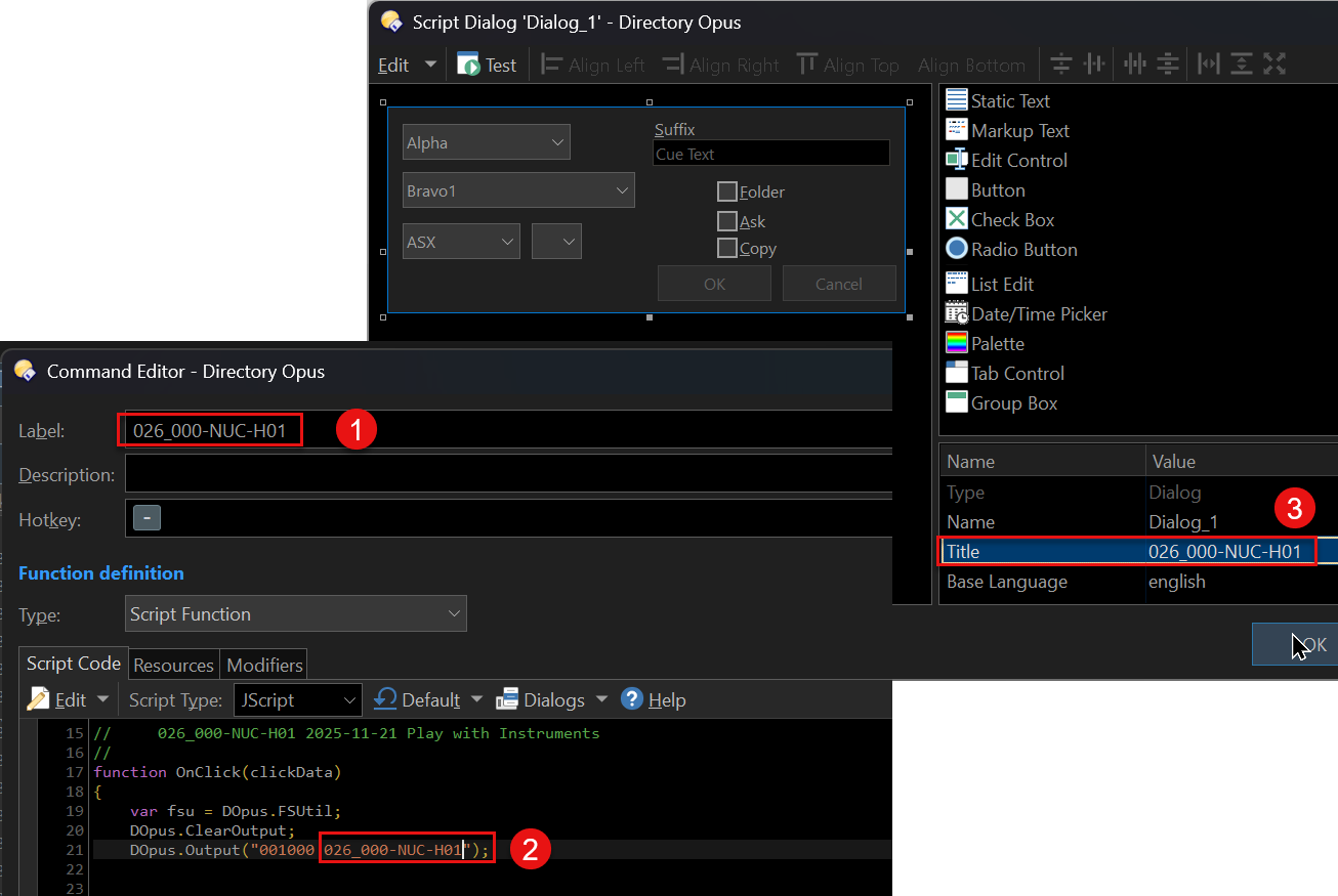

When I update the version on a script that runs a dialog box I have to do it in 3 places manually.
Imagine I being able to access one of them from the other locals?
So for example if this location
Command Editor > Label Field (Loc 1)
Could be accessed from within the Editor with an Opus internal environment variable reference of some sort e.g. @EditorLabel or some such. Then I don’t have to update Location 2
And the same reference in location 3.
Now all I have to update is the Command Editor label.

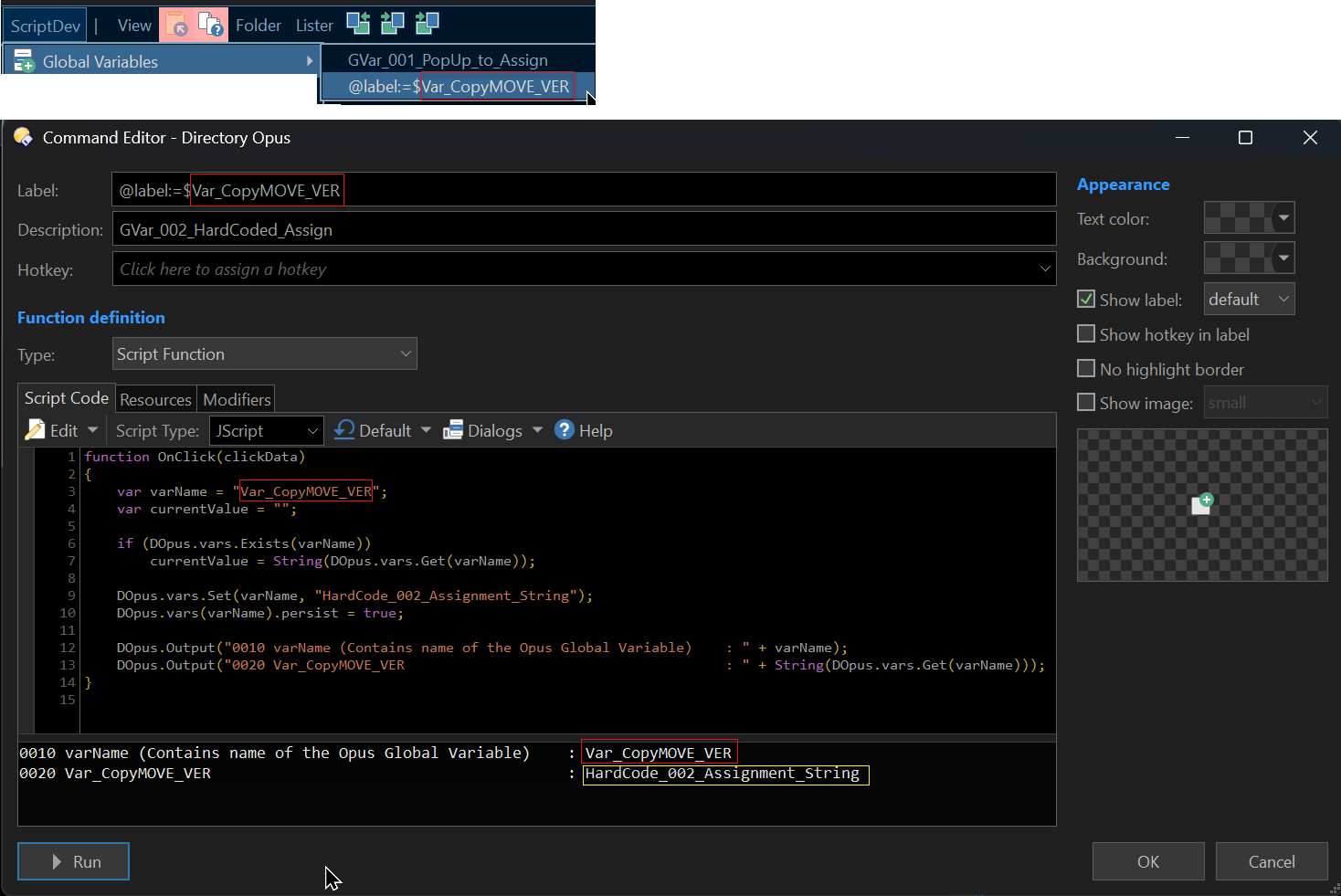

Does Opus resolve "regular" variables (with global scope) in a label maybe or by using an Evaluator? I did not check. That dialog title should be easy to update / set from within the script.
Yes.
@label:=$glob:MyVar
Yes, now that I see it, I remember having played with that variant already. I was actually thinking of using the expression directly as part of the Label field in the button editor, but that @label syntax should work as well. It probably also allows to concatenate static text with a version string from a variable. So @slouw, there you go and thanks lxp! o)

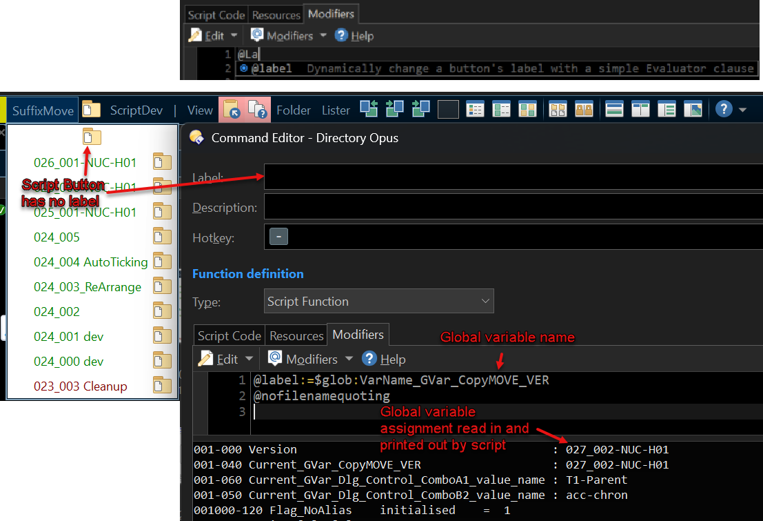

The label field probably does not support variables and / or modifiers?!

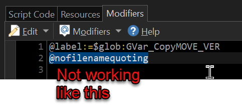

Putting a variable right in that label field is quite a reasonable idea, iirc I had the same some time ago, but did not try (or did I(?), I'm not sure), but I think for now, you need to move the label modifier and assignment it into the button code (above the jscript part).

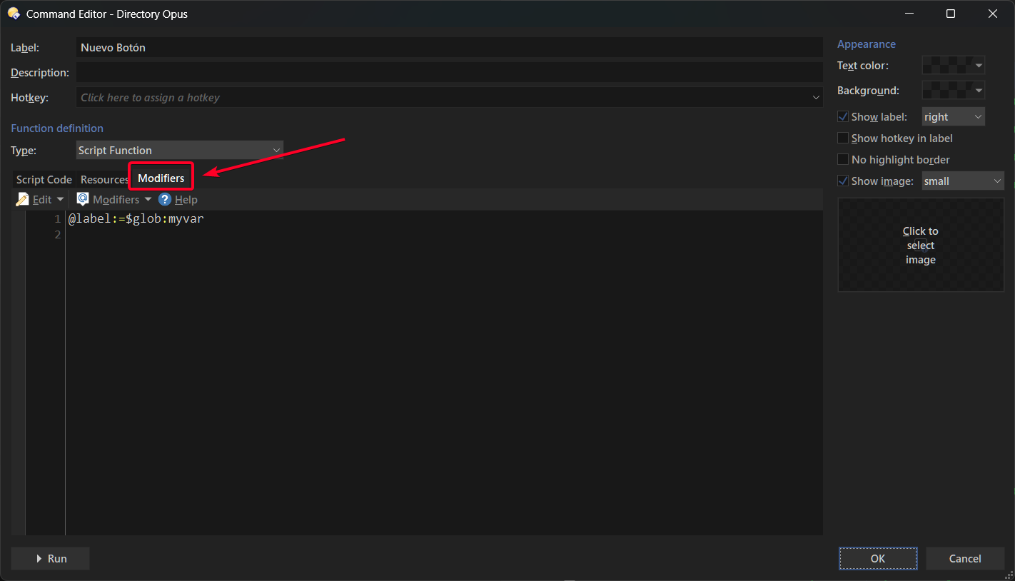

You need to use it in the Modifiers Tab:
Also, FWIW, it would be better to use a Script Add-In instead.
Also, the dialog's title doesn't necessarily have to match the script name, you can use a regular name and then change the actual title to whatever you want inside the script.

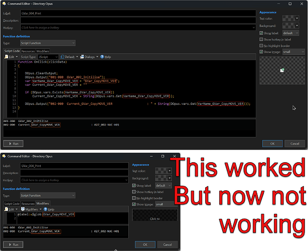

I am reading in the GVar(s) successfully into my script and have it availalble in there and am using them. But populating the Label is not working
What am I doing wrong?

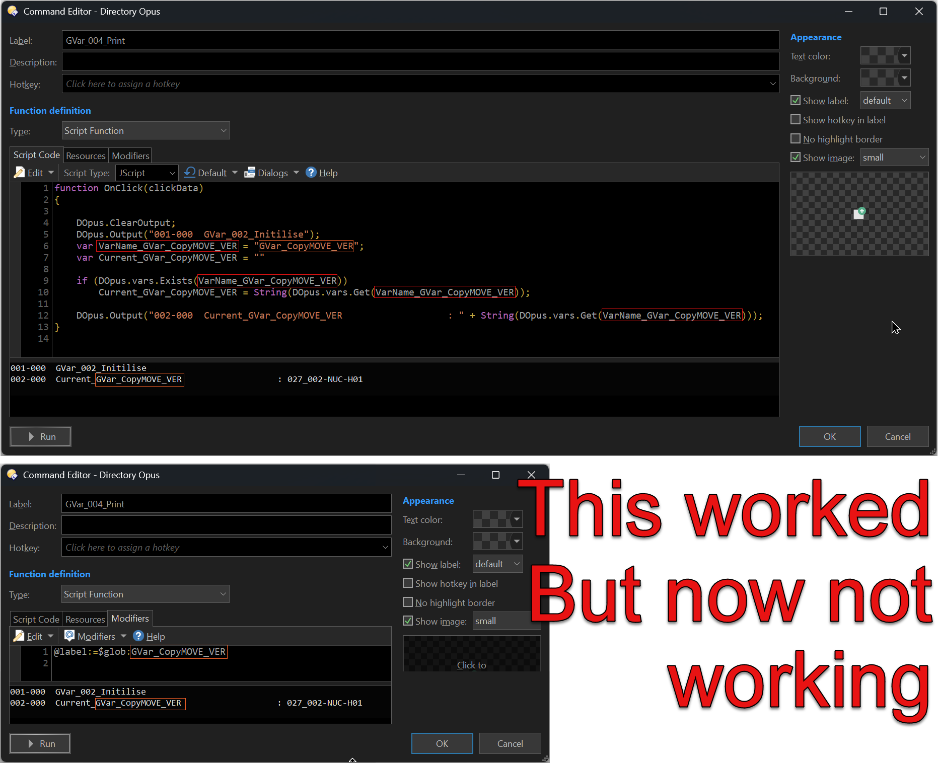

Funny I got it working with this sample script
My “Main” script where I want to get it working does not work.
My main script already has @nofilenamequoting
So I just added the required line so it looks like this:
So I added @nofilenamequoting to my sample script and broke it.
Removed @nofilenamequoting from my sample script but now it wont work?
Retarted Opus still my sample scrip will not work now.
Puzzling…..
DOpus Button.dcf (1.1 KB)
Above is my test script
It references a Global variable called
GVar_CopyMOVE_VER
It WAS working then I broke it but cant unbrake it…..
Going to reload my PC now and make coffee then test again
Wish me luck….

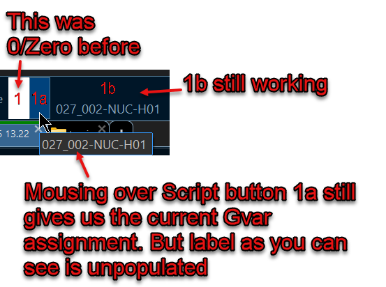

If you're changing the value in the script itself you need to force the toolbars to update to show the new value. Add clickData.func.command.UpdateToggle(); to your script after you modify the value.
Thank you again @Jon
I inserted this toggle command as you suggest but no change.

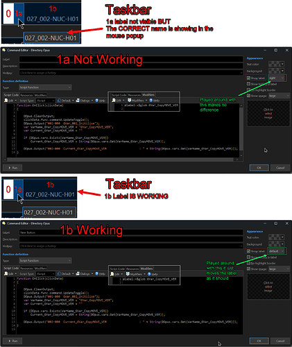

For clarity
Script0/Main script - The original script from which this enquiry arose
Script:one::a_button_blood_type: /Test script - For specific testing only. Got it to work then broke it and I cannot fix it again. (“This worked but now not working” - above. Also the button attached above is Script 1)
Script:one::b_button_blood_type: /Test script - Manually created from scratch now. IDENTICAL to Script1a. This at this point is WORKING.
Consider 1A (Broken) and 1B(Control - working)
I have tried to present them as clearly as possible with screenshot below.
At this point I think it worth stating the version I am running
Directory Opus 13.15 Build 9259 x64
OS 10.0 (B:26200 P:2 T:1) SP 0.0
Upgraded to latest stable release
Directory Opus 13.22 Build 9428 x64
Standby for test
No change whatsoever accept that Script 0 picked up a different icon.
Script 1a = Still broken, still showing GVar assignment upon mouse over
Script 1b = Still working
Next steps - I am on my work laptop tomorrow. Will see if fault happens there also.

1a = Broken (Same as my home PC)
1b = Working (Same as my home PC)
Recall 1a is the same (I think???) as 1b just 1a had @nofilenamequoting added then removed.

Both buttons change their label for me.
Note that in order to directly note this whenever you change the variable value, you need to use:
At the very end in your GVar_002_Initilise button.
