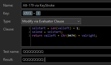

You can use @sendkey to send a key press.
This will only work while inline renaming and you can set a custom key shortcut.
Preferences / File Operations / Renaming Files / Control Keys
selstart = Len(valleft) + 1;
selend = selstart;
return valleft + Chr(124) + valright;

I accidently put the wrong code in there... changing to 179 doesn't put in the 'Box drawing character single vertical line' Chr(65372) works though but not the exact same character.
This one! Chr(9474)
Inline Rename Update01
With thanks to @Yonder this works exactly as intended
(Although I do not understand the logic at this point.
Soem work for me to do):

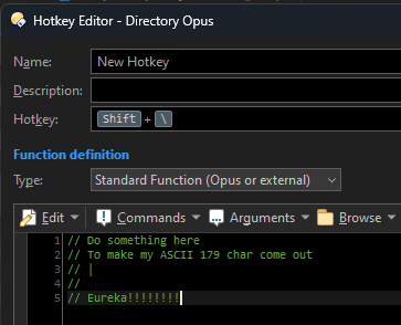

Inline Rename Followup02

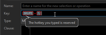

I am suspecting I will never get around this. (Any ideas?):
I want a solution that will work Opus wide as I have renaming scripts that use popup dialogs.
Will update any findings I make.
Cheers!
Replacing the | key process-wide seems like a bad idea. There are times when you need to type a | character.
Changing it for just Inline Rename might make sense, but wouldn't affect other places.
Personally, I would put it on a (different) hotkey so it can be process-wide (or even system-wide) and so that the | character can still be typed when needed.
