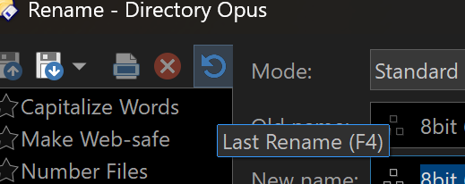

Could you guys add a "Last Used" button on the top of the Advanced Rename tool, pls. It would load the last used settings.
Your wish is our command. Hey presto!

Oh damn. Perfect! :cherries::ok_hand:
