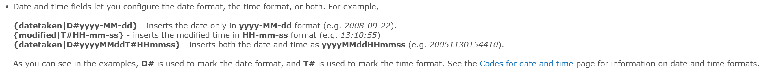

You need to use the T# and D# codes to indicate a time or date format pattern, as described in Keywords for Columns in the manual.
Thanks, so in case anyone stumbling upon this question and wanting a
TL;DR
{created|D#yyyy-MM-dd T#HH-mm-ss}
