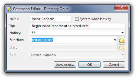

Adding to what Michael just posted, you need to double-click the F2 line shown in his screenshot to open the hotkey and see the actual command it runs, like this:
The main list only shows the "name", not the "function" part. The function part is what's important.

What actual command is F2 set to run? Not a summary of what you think it does; tell us the actual command next to the word "function" when you edit the hotkey.

The function when I edit the command says "rename inline"
