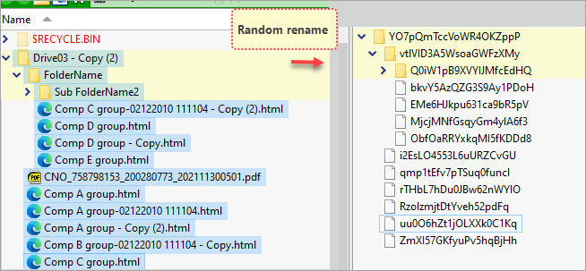

Rename files with random alphanumeric characters

Wonder, would it be possible to change the script so it randomly renames both sub folders and files, this whilst selecting the parent folder.
Meaning: select folder: run script - any sub folders and files to be randomly renamed.
The script can do it, but one needs to expand folders and files in the right window panel, select them and then perform the rename.However, not just by selecting 1 parent folder.

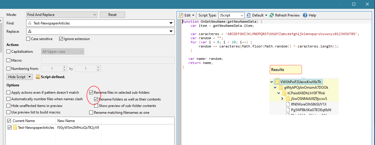

Change
Rename PATTERN * TO *
To:
Rename PATTERN * TO * RECURSE
The folder will not be renamed.
Very sorry for the delay. One way or the other I didn't receive a notification of your response. Just now stumbled over your reply.
I have made the changes and indeed the files in sub folders are randomly renamed, but I could not get the sub folder names renamed.
FWIW - as a workaround - I created a separate preset (within "Rename") and checked "Rename files in selected sub-folders and Rename folders as well as their contents".
That seems to work.

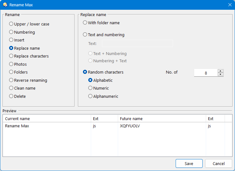

I'm very glad to know this little script is helping you so much. I just published another script (Rename Max) (link) with more customizable options, such as replacing the entire name with random characters, whether alphabetic, numeric, or a combination of both (alphanumeric), and you can also specify the number of these characters.
