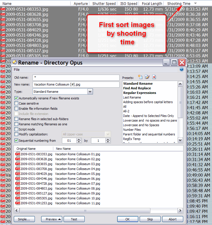

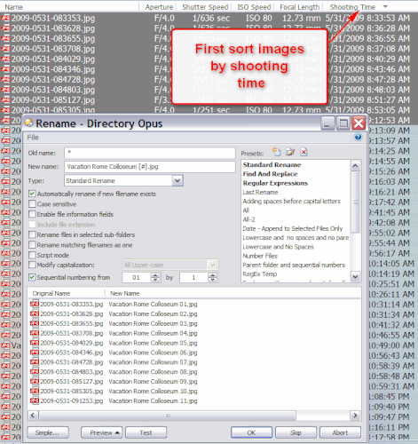

Taking a different approach, if I correctly understand what you are trying to accomplish, here is the way I would go about it. First I would sort my images by shooting time assuming such EXIF data exists. If it doesn't, I'd find another way to sort the images so from top to bottom they are in the order you want.
Next I'd select the images I want and run the Opus Rename dialog (either press the Rename toolbar button or go to File/File Commands/Rename). Switch the rename dialog to advanced mode and then configure it like the screenshot below.
One side note. In the event you also manage your images in a special program made to do so (eg IMatch, Lightroom, iView, etc) you should always rename your images within that program instead of an outside utility like Opus.
