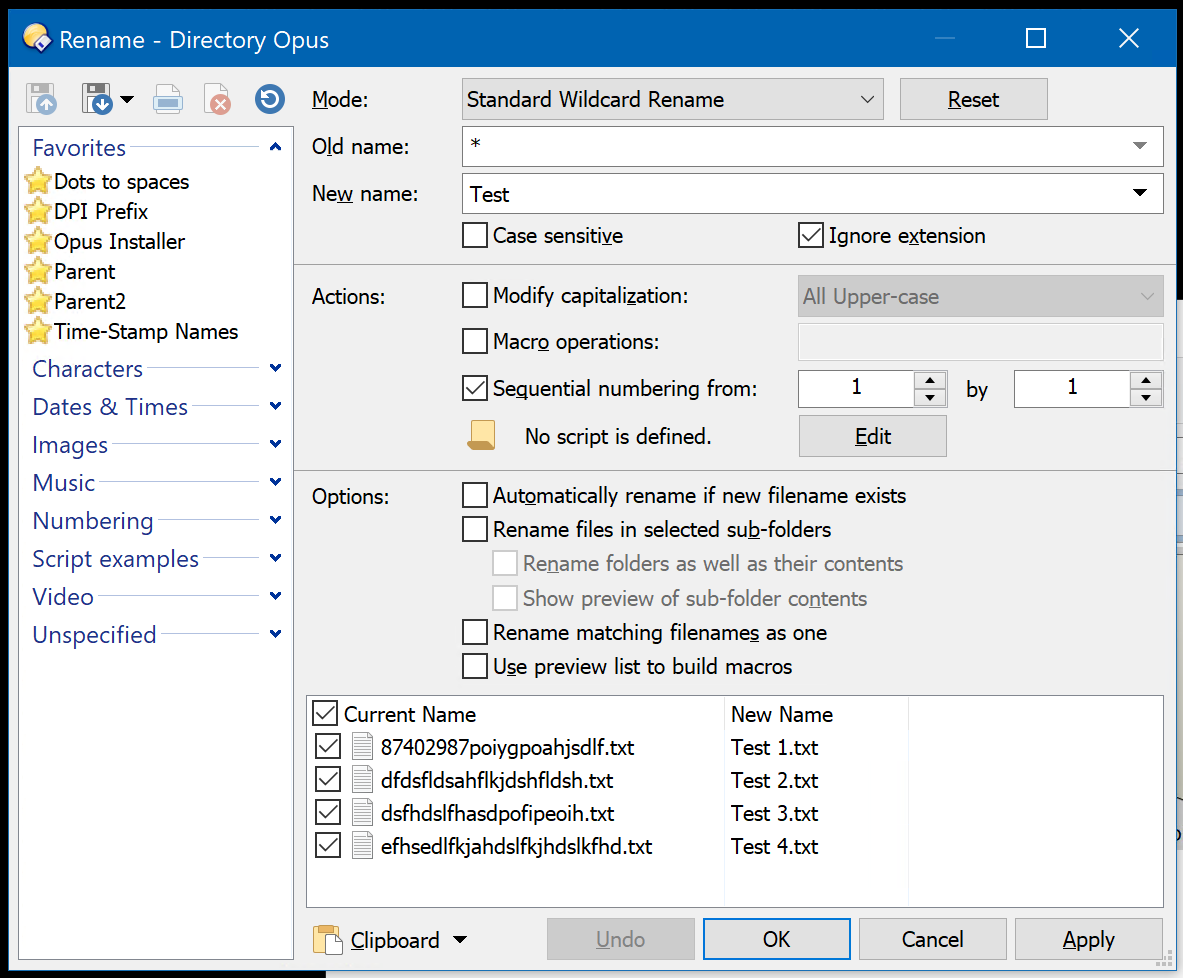

Alternatively, if you want to do it via Opus's advanced Rename dialog, which gives you more control (but also more user interface to deal with):
  • Select the files and click Rename on the toolbar.
  • Turn on the Sequential numbering from checkbox.
  • Change the New Name field as appropriate.
The preview at the bottom of the Rename dialog will show you what will happen and you can adjust the settings and patterns to get what you need.

you say "select, then turn on, then change"
i have found when you open the RENAME tool the FIRST thing you must do (after select) is click SEQUENTIAL, as if you dont do this then the rename operation fails, so maybe there should be an instruction like, CLICK SEQUENTIAL FIRST. anyway another DO gotcha solved but a LOT of wasted time to boot.
checked this and "rename..." was ticked. the issue was the order in which SEQUENTIOL, as described moment back is ticked. so anyway :upside_down_face: :upside_down_face: :no_mouth:
You can tick it whenever you want, right up until you click OK.
