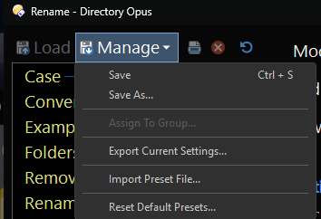

Random numerals rename.orp (463 Bytes)
An .orp file can be imported into the advanced rename dialog

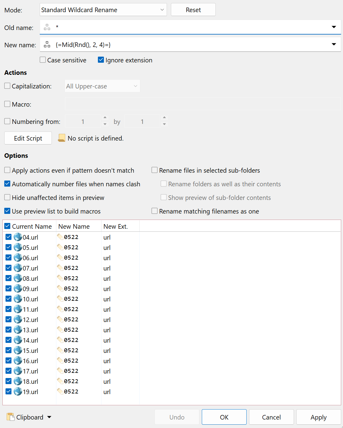

Escaping doesn't help here. Even when used directly in the Renamer, Rnd() will only generate one value:
Interestingly, when the files are actually renamed the second half receives a new random number:

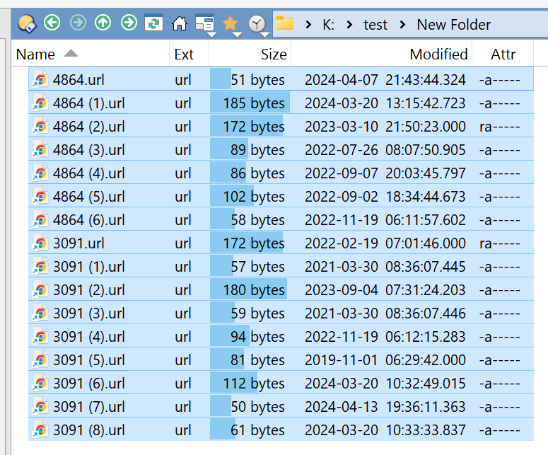

Yes, it is. E.g.
Rename PATTERN=* TO="* {{=Left(target, 4)=}" IGNOREEXT AUTONUMBER
