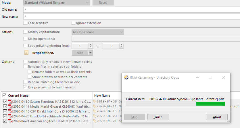

Edit: not entirely perfect yet, because sometimes it happens that my popup disappears into the background and the progress dialog pops up. I cannot abort this action anymore and have to terminate DO with the task manager.
Edit2: remove the this last line from my script and so far no freeze again.
var dlg = DOpus.Dlg;
//dlg.window = DOpus.Listers(0);
Let's see how this performs in live scenarios later on.
