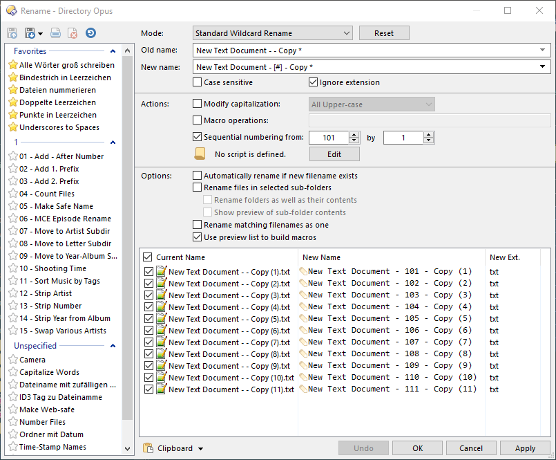

Are those the real filenames you need to rename, or are the real ones different? The exact solution may depend on the names, but this will work for the examples you've given:
Old Name: New Text Document - - Copy *
New Name: New Text Document - [#] - Copy *
(And the rest as you already have it.)

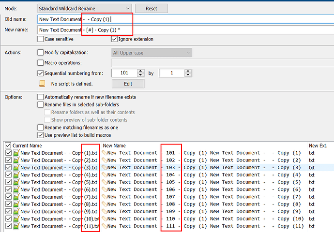

I tried your suggestion, but it did not work:

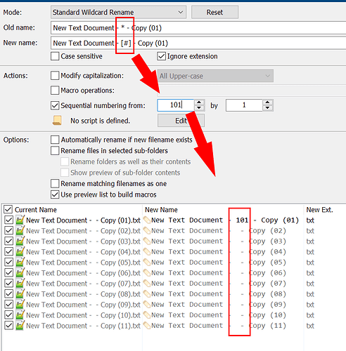

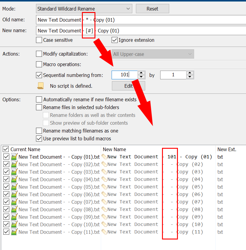

The one way that seems to do the first file as I need it is shown in the screenshot below, but it stops on the first file. I need the sequential new numbers inserted where is being pointed in the following screenshot:
I hope there is a way to do this, some expression syntax, or a script.
You have to delete (00) from both Old Name and New Name fields.

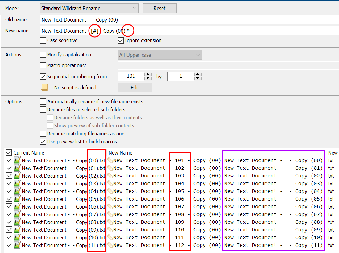

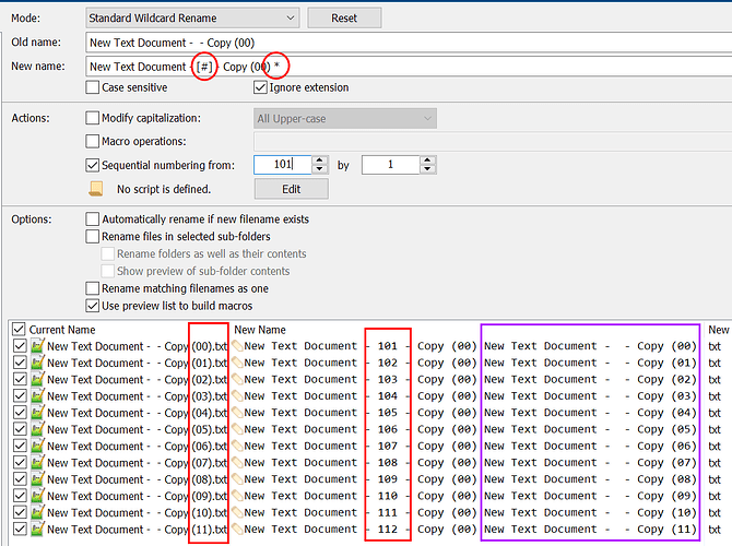

I did exactly as you said (see screenshot, I removed the zero) and I don't get your results. No number sequence is inserted.

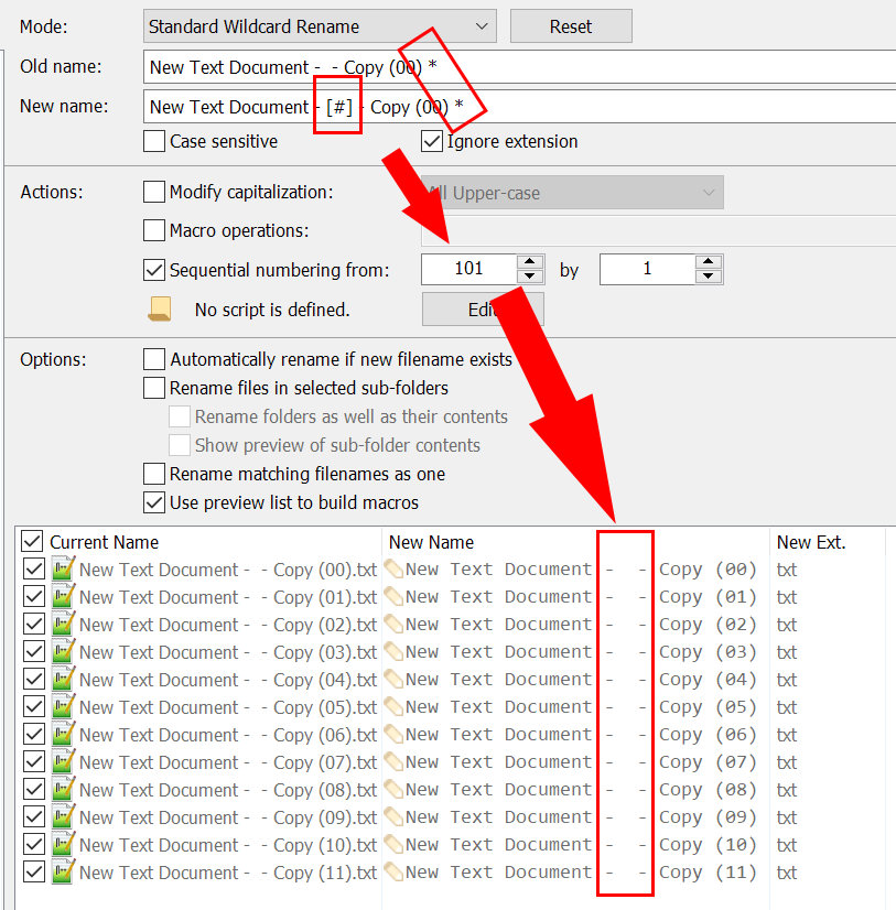

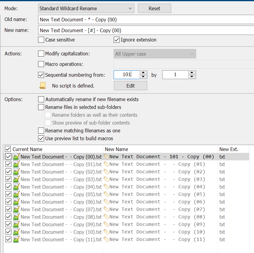

However, I removed the asterisk from the "old name" field and now I get what I need BUT it duplicates the file name onto itself, and I did remove the zeroes:
It actually works when the zeroes are present, and still duplicates the file name, I mean, when I do not set the asterisk in the "Old name" field:
Further more, I even clicked the "Reset" button next to "Mode" just to make sure, before entering the * and the [#], and same result.

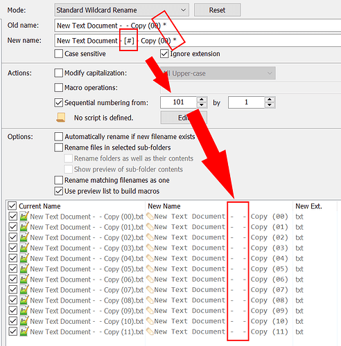

Your screenshots show you still aren't doing what I said (and Hardkorn reiterated).
The first screenshot has no zero. I did as you said. I compared it to your screenshot.
The second screenshot has no zero (just as you said to remove it), and it shows that it works if I don't type the * in the "Old name" field BUT it duplicates the file name onto itself. I know you did not suggest this option, but I discovered that it inserts the numbers where I need them but with another glitch (the duplication of the name)
The third screenshot is the same as the second one but with zero. It is to show that not putting the asterisk in the "old name" field still works, but still repeats the file name glitch.
Aside from the second and third example screenshots (let's ignore them since that is only what I noticed), where am I failing to do as you said based on the first screenshot? I mean, if we only look at screenshot 1, which is doing exactly as you said?

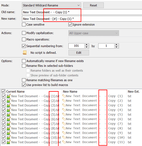

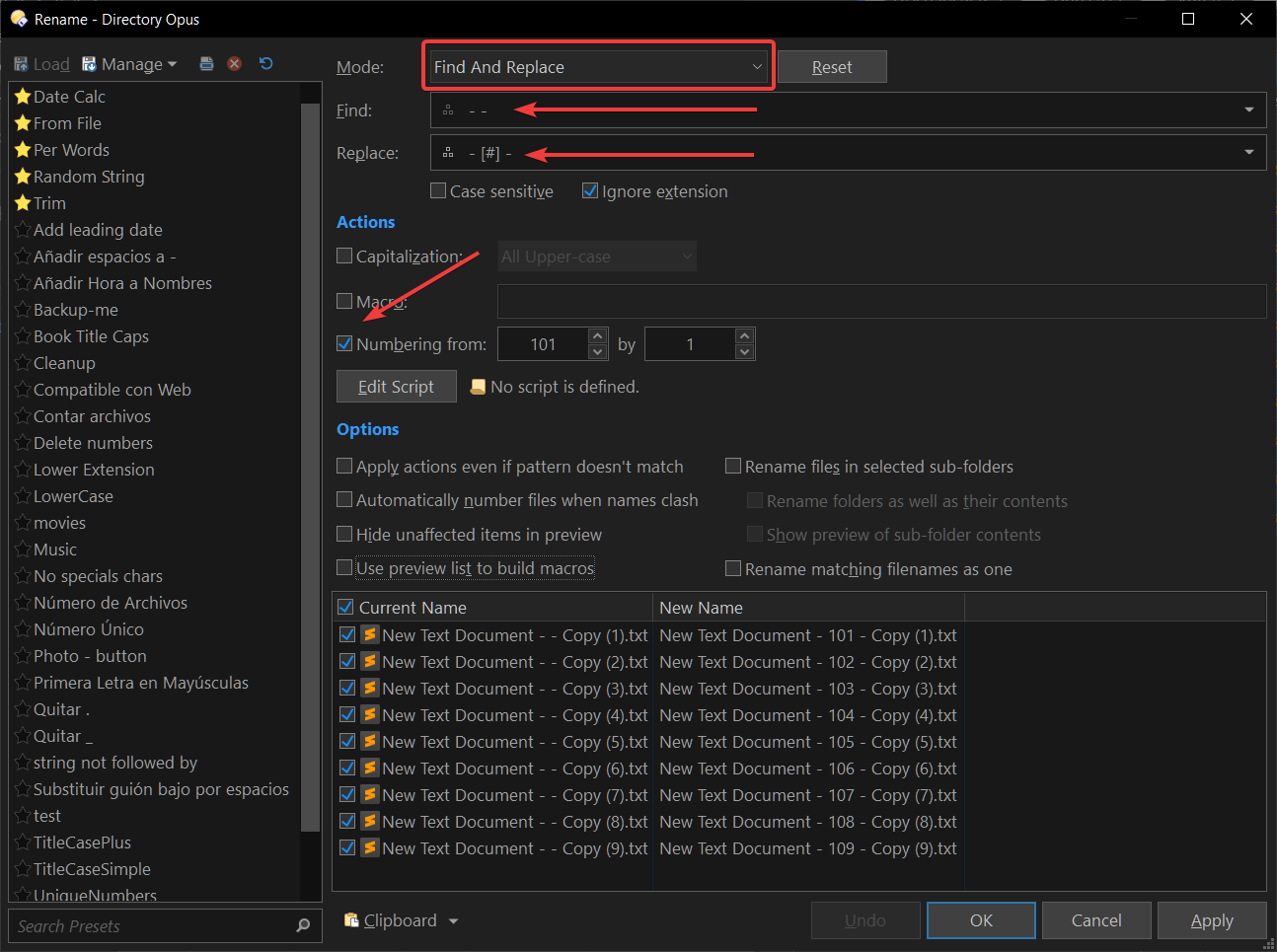

You still using the numbers between parenthesis in your pattern. That's why it doesn't work. You also can try using this config:
In Find: - -
In Replace: - [#] -
Check Numbering from and put the number you wish and that's it.
errante,

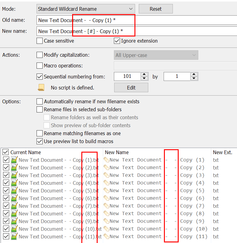

I see the mistake now.
Your solution works in one go.
Also, since now I see MY huge oversite, now what Leo and Hardkom were saying also works. I was removing the zero from the actual file name before activating the Rename feature. Now I see (I somehow did not see it in Hardkom screenshot, but it's there) that you have to remove the (01) or (02) from the "Old name" and "New name" fields.
I apologize for those oversights.
Both methods work flawlessly.
