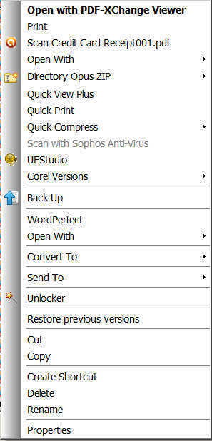

When I right click on a file, the various entries do not have one of the characters with an underscore (ie so that an entry is selected with a keystroke), eg as in Windows Explorer:
While in Opus 9 the following appears:

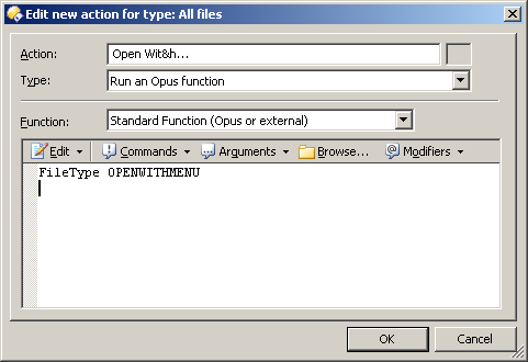

Go to Settings -> File Types -> All Files -> Context Menu -> Open With..., click New...:
Set the Action (which is really the item's name) to Open Wit&h...
Leave the Type as Run an Opus function
Leave the Function as Standard Function (Opus or external)
and into the main box put: FileType OPENWITHMENU
You'll now have two Open With menus, unfortunately, but you'll be able to trigger one of them with the H key.

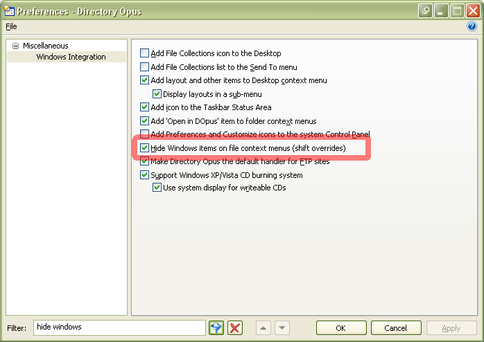

FWIW - the method you used to add that item to the Windows context menu will be HIDDEN by Opus if you've enabled this option:
If you press and hold SHIFT while you right-click on a file, the WordPerfect item should appear - and hitting the w key will work as intended.

I posted a small part of the right click menu. Here is the full version, which shows the WordPerfect entry:
