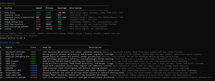

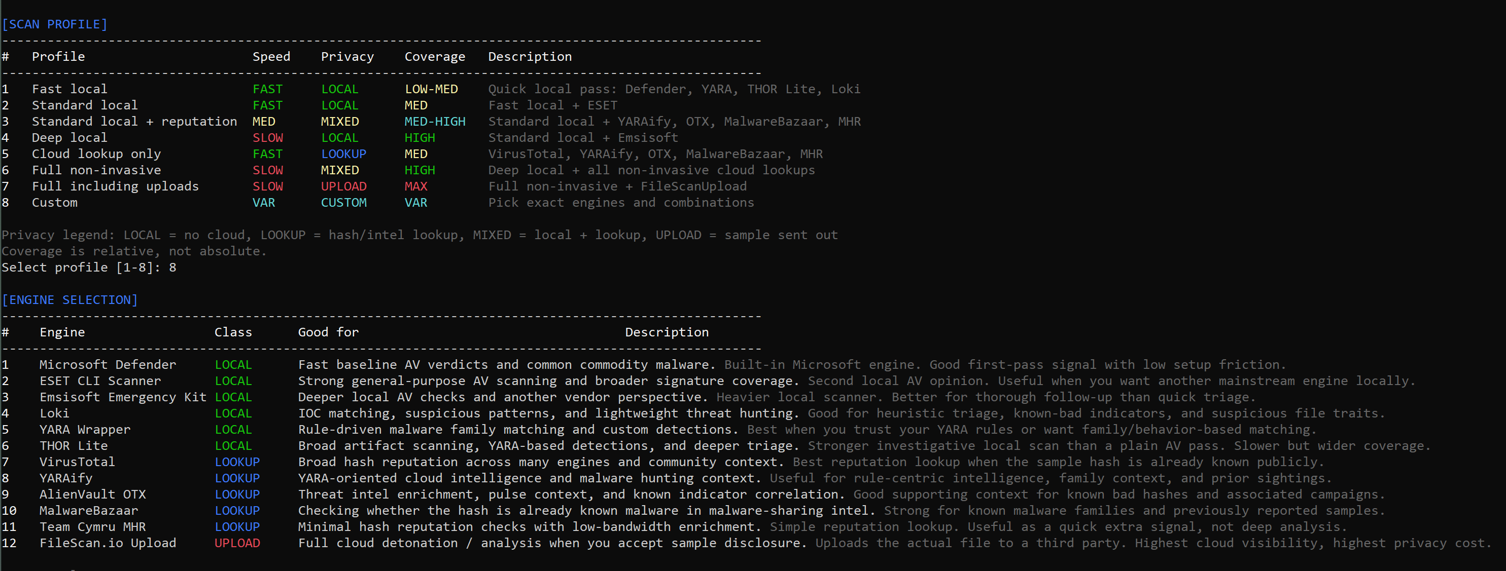

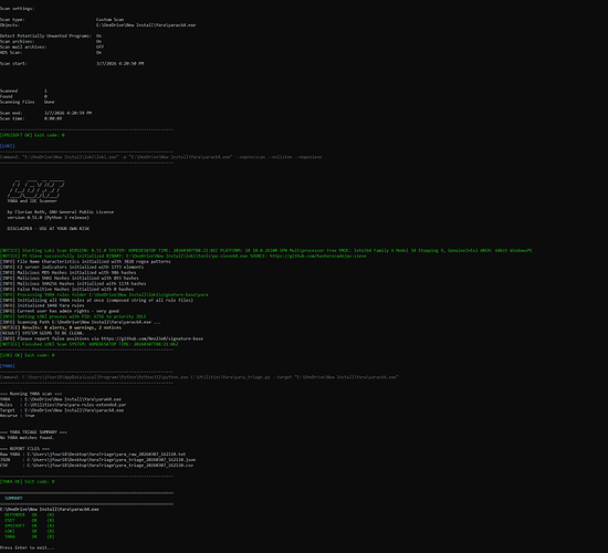

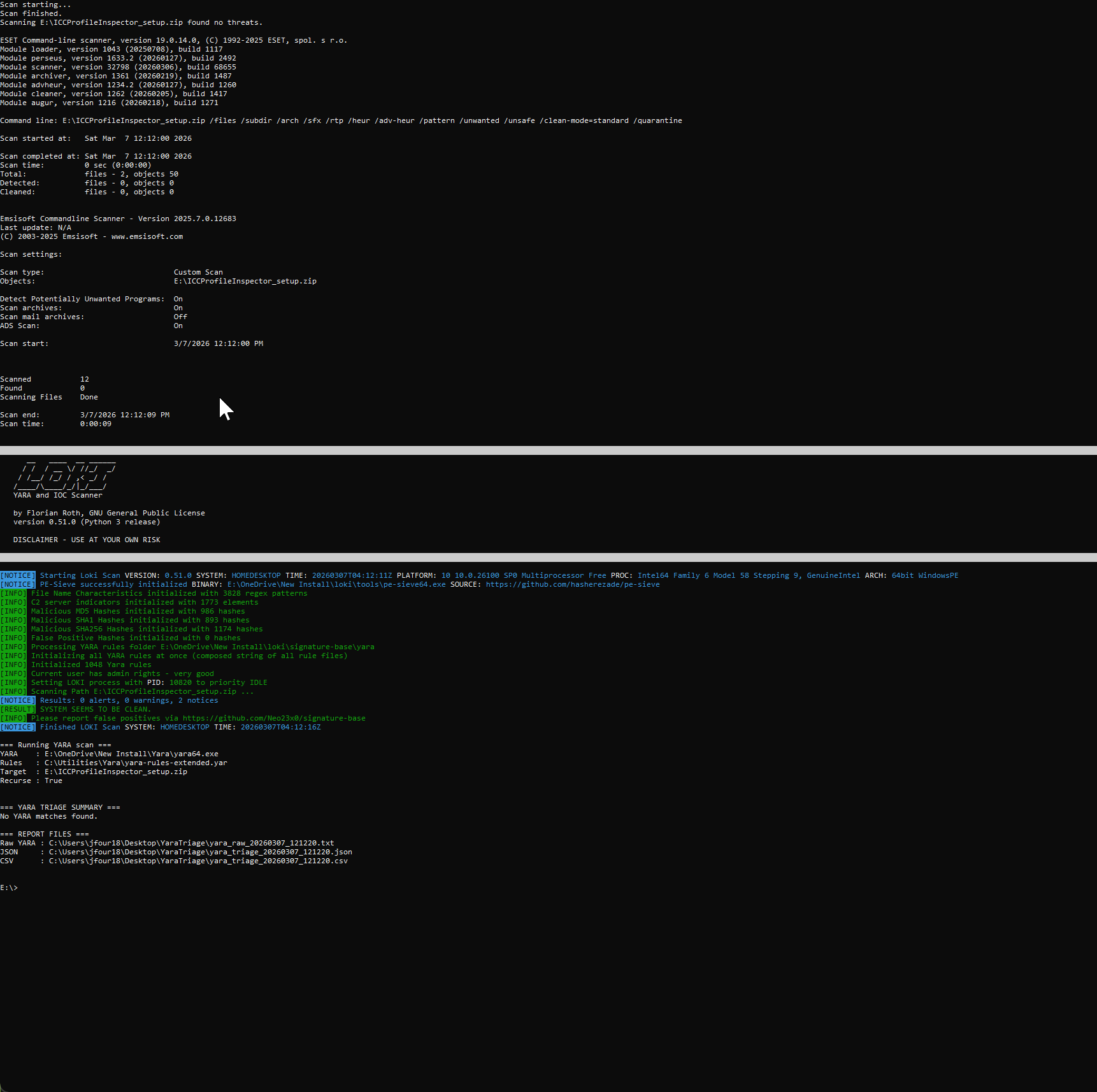

Example CLI output:
Alternatively use a Python Wrapper for cleaner output
Example Python Wrapper Code - save as "multi_scan.py" - not thoroughly tested

Button code to launch python wrapper
@admin
py "E:\OneDrive\New Install\Yara\multi_scan.py" {allfilepath$}
