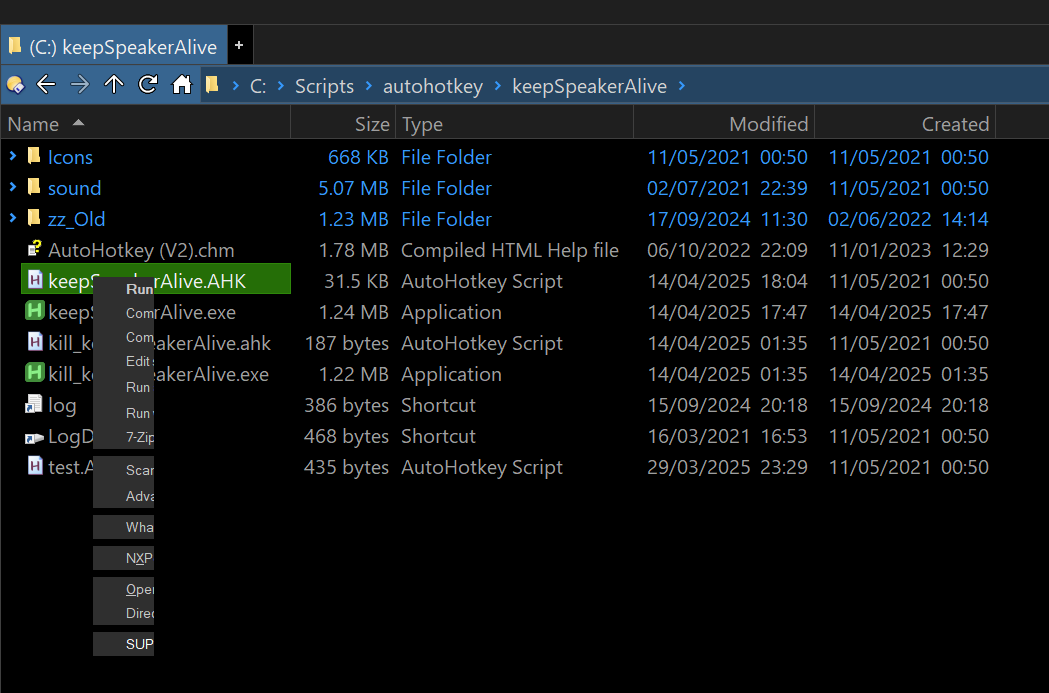

Just now I believe that I did something that I have done without a problem hundreds of times, but this time it seemed to cause screen corruption, and unresponsiveness, within Opus.
The thing that I did was to right click an AutoHotKey script in order to use the right-click menu to compile the script. At some point within that procedure - or, possibly, upon running the compiled program - this occurred:
A little later, other parts of the Opus window became messed up. I do not think that the AutohotKey program could have caused the problem.
I restarted Opus and the problem has not reoccurred.

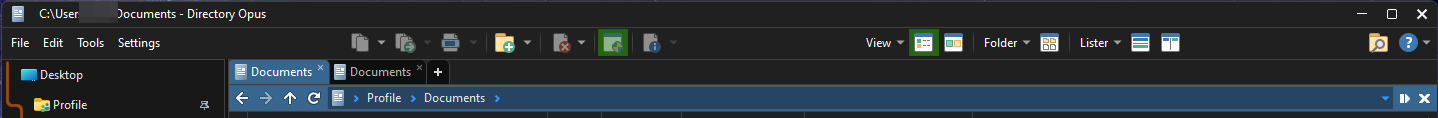

I have similar experience with right-click context menus. Although for me it happens once in 1-3 days. When it happens, graphics of every opened DOpus window (including tray icon menu) is getting screwed, and only full process reboot fixes that. Happens randomly, but the trigger is always the right-click context menu of a file/directory/directory background. How can I find out what could be an issue here?
And by the way, it is happening since like 13.10-13.11. Not a recent bug.

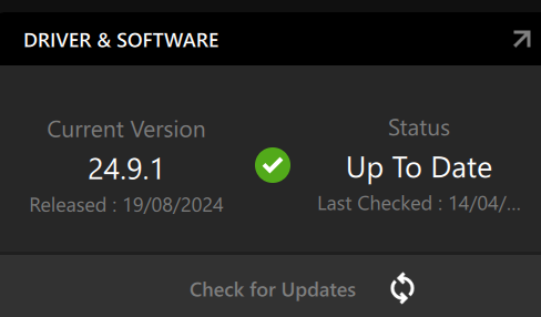

Hello Jon.
I'm on the latest stable AMD driver:

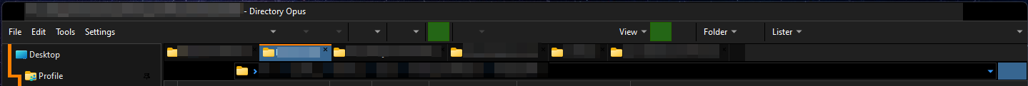

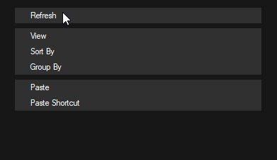

Happened again, randomly, when I opened directory background context menu (I'm used to Refresh button in it) in one of the tabs in a tab group.
Pixelated chunks are edited paths, everything else is an artifact in the program.
Statistics for dopus.exe at that time:
-Handles: 2259;
-USER Handles: 3614;
-GDI Handles: 9997

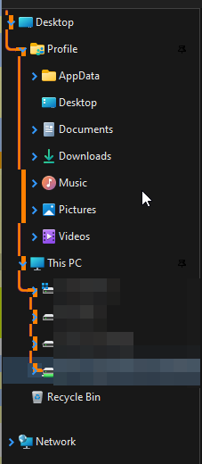

P.S. To compare, this is the normal view of my lister:
