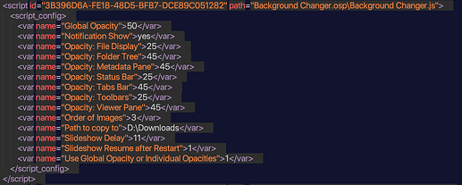

Changed Global Opacity to 10 and this is what the ocx looks like

scriptconfig.oxc stores info for all scripts that use ScriptConfig properties, even those no longer installed. So there may be more than one entry for your script in that file. You should pick the current/correct one (it's a bit tricky but the GUID is what changes). You'll notice it by the change in the file when you edit its configuration. That's why a proper text editor is needed (so you don't need to close it and reopen it).
If you like, copy the relevant configuration where you can reproduce the problem and paste it here so others can try injecting the same configuration and see if it's related and can be reproduced.

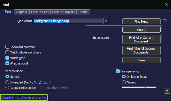

cannot post scriptconfig.oxc (security reasons), but there seemes to be 3 different Background Changer.osp entries
and only 1 Background.osp - the current running and working script.
