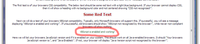

Excel uses VBA rather than VBScript so it might not be a good test. Not sure what the best test is, but it might be worth going to this test page using Internet Explorer and seeing if it says "VBScript is enabled and working!" (see my screenshot below):
b2knet.com/
I don't know if IE uses VBScript via the ActiveScript API which Opus uses but it's VBScript so it's a closer test than Excel.

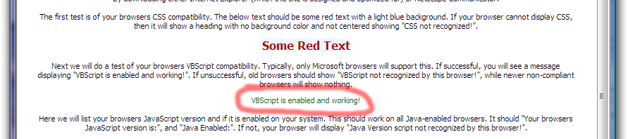

[quote="leo"]I've been using Vista SP2 for a few days and don't have the problem so it's probably not that.
b2knet.com/
I don't know if IE uses VBScript via the ActiveScript API which Opus uses but it's VBScript so it's a closer test than Excel.[/quote]
It was a good idea, thx for showing me that test page. Still it didn't end up as it should.
That is not the source of the problem. It's either IE not using VBScript via ActiveScript API or it's even ActiveScript API working correctly. That's becoming ridiculous :unamused:
