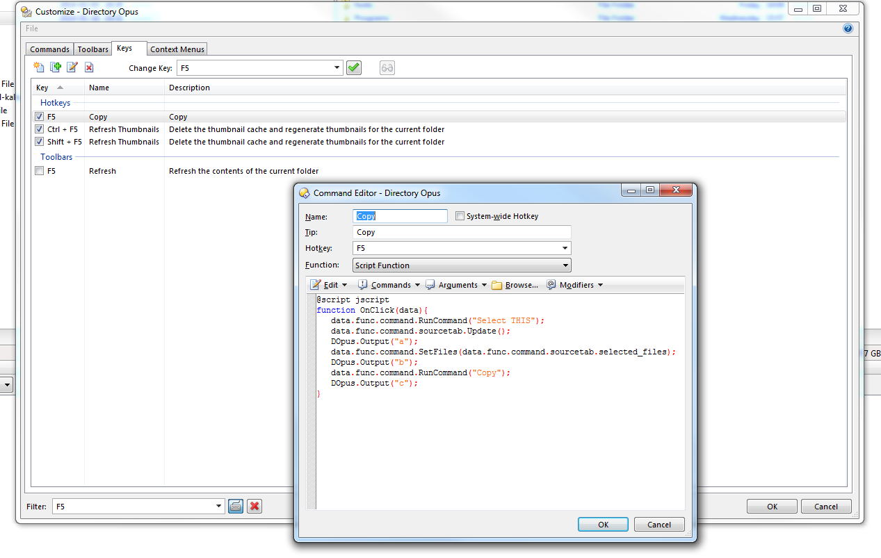

I deselected the other function of F5 (unchecked its checkbox).
The new script only selects items (just like the one I posted earlier) but unlike the earlier script, doesn't copy when I press F5 a second time.
I uploaded proof :smiley:.
Did you try with a file or a folder?
I think the script as it was would only copy files.
If you change selected_files to selected it should work with both:
@script jscript function OnClick(data){ data.func.command.RunCommand("Select THIS"); data.func.command.sourcetab.Update(); data.func.command.SetFiles(data.func.command.sourcetab.selected); data.func.command.RunCommand("Copy"); }
It was with a folder :slight_smile:. Now it works. Thanks a lot Leo :slight_smile:.
