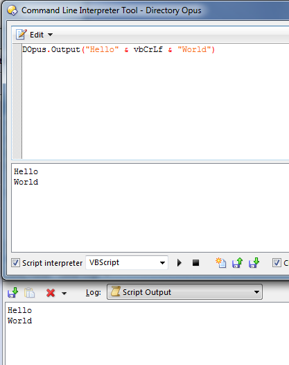

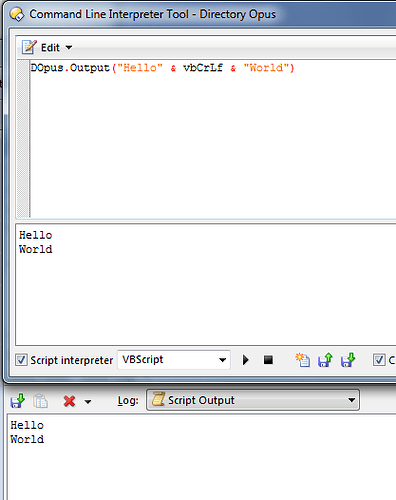

Seems to work here:
Leo,
You are using the CLI while he is using the LOGMSG function. Not knowing the innards of Dopus, I cannot say, for sure, that they are not the same. But I would be more convinced if yours worked running his script (of the applicable part of it). Not that I have a dog in this fight - just saying.
The screenshot shows both the CLI and the script log panel.
