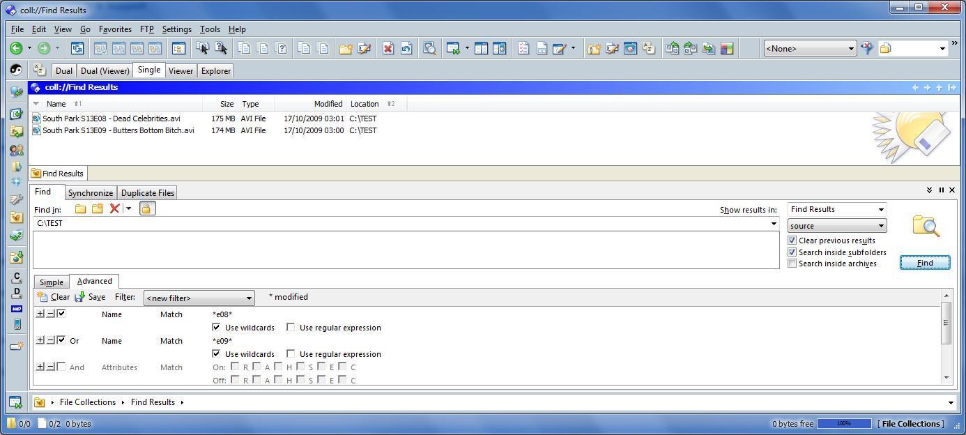

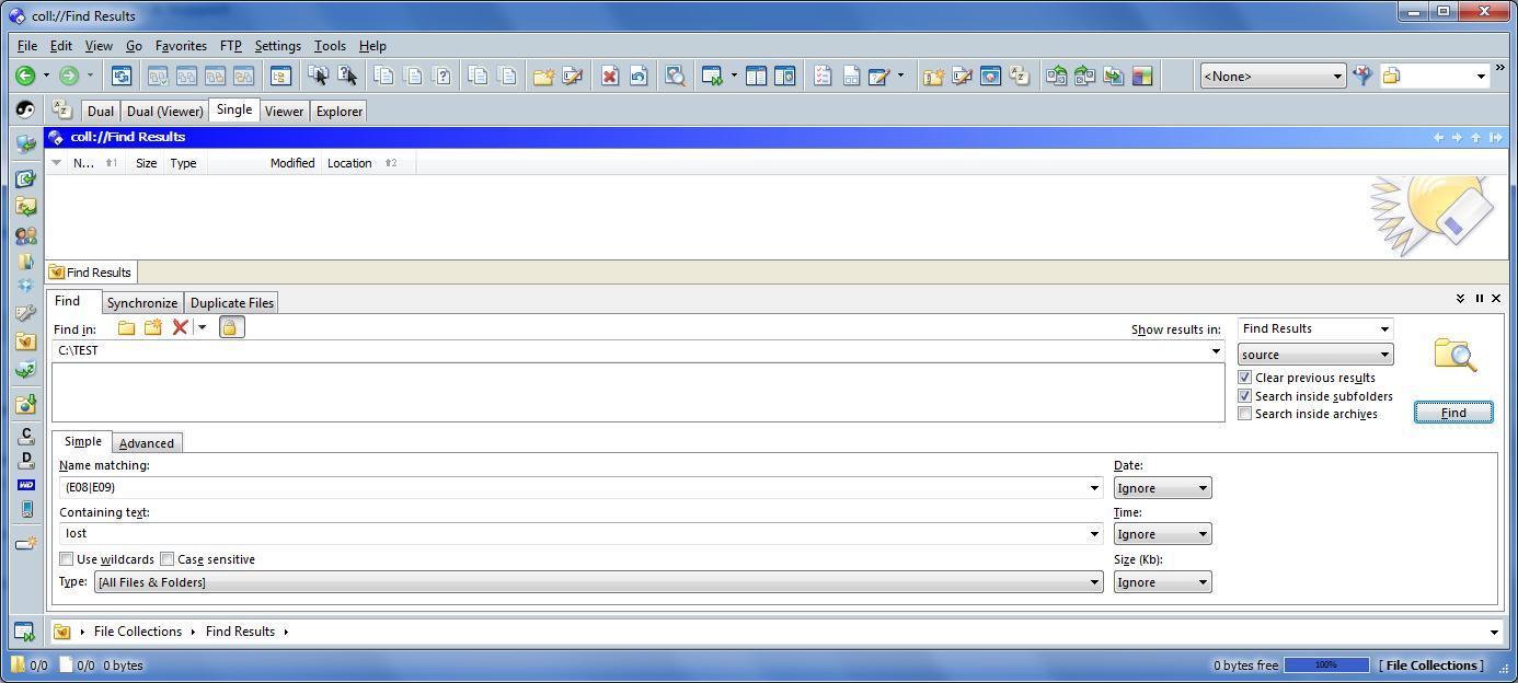

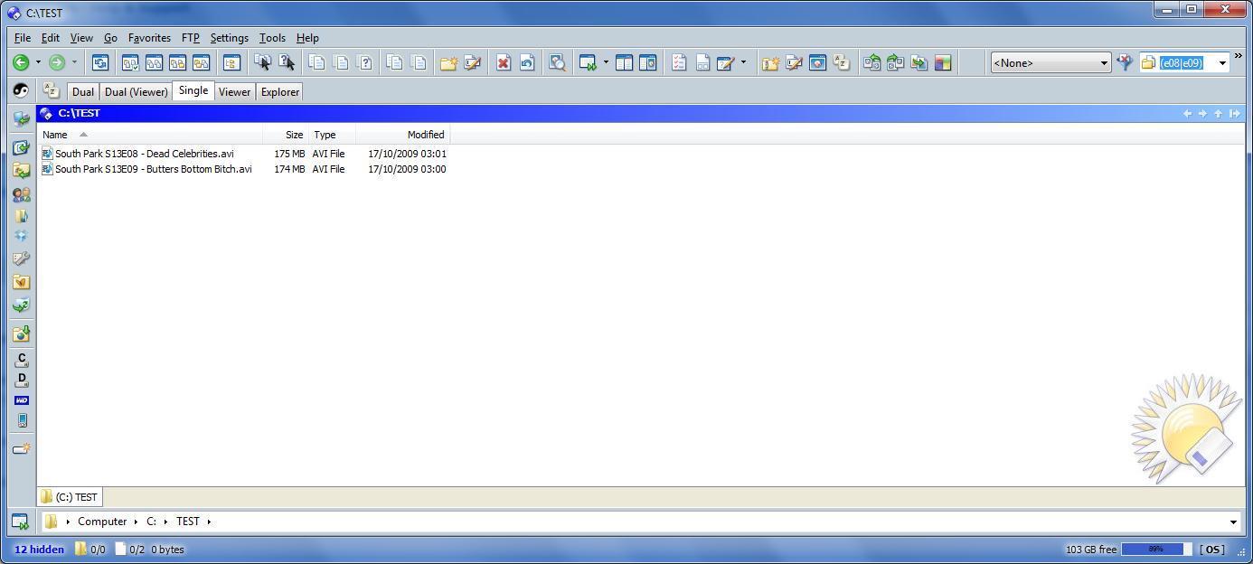

If I use the file filter to search for files with "e08" or "e09" in the filename I enter the text (e08|e09) which filters the relevant files (two in this case). If I use Tools --> Find Panel and enter the same text, this results in no files being found. If I switch to advanced search and enter "e08" or "e09", the correct files two files are found.

File Filter
Find Panel: Standard
Find Panel: Advanced
Your toolbar filter field must have the Partial Matches option on, which effectively puts a * at both ends of whatever you type into it. So typign (e08|e09) into it really filters on (e08|e09) which is what you need to use in the advanced find panel.
