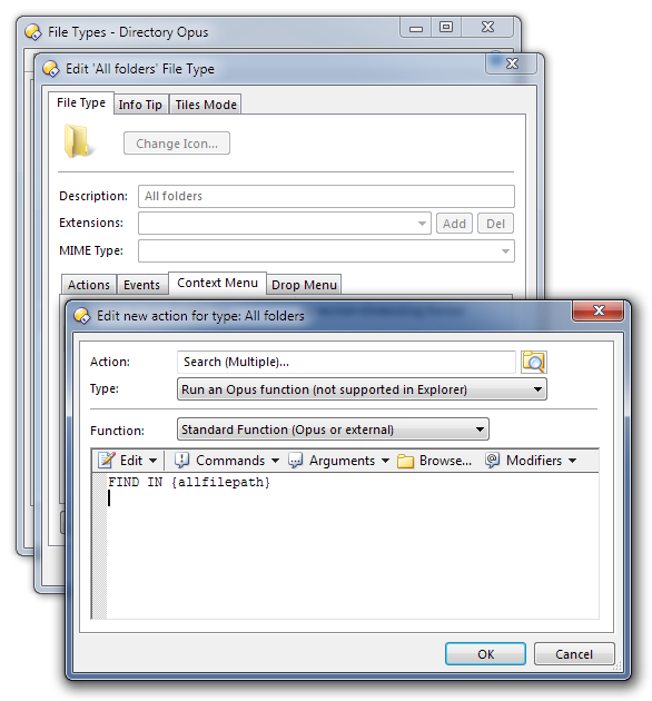

You could add this to the filetype context menu for All Folders:

Again, thanks. You have cleared up much, and provided a sol'n for the clearing of searched folders (yes, not the clearing of 'results' . . . ). And I'll check out the filetype solution for folder selection (and educate myself a bit more on Opus).

If you use the context menu method (or equivalent 'button') which passes the 'selected' folders to the Find dialog, then it will automatically "replace" whatever previous folders you've searched.
