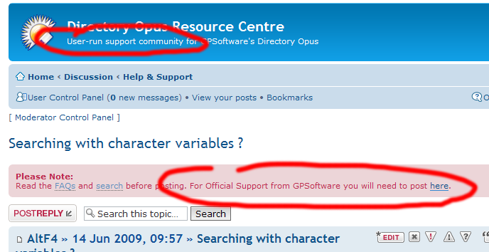

You're nagging the wrong people/place.
Well, I don't need support, but rather, I am just stating a feature that would be nice to have in the future.
So the devs don't read their own forums?
As Leo pointed out, this is a USER-RUN forum, the devs do pop in from time to time but are under no obligation to do so. Official support (including feature requests) for Opus is available through their website. Whilst it can be handy to discuss requests here, they must be made officially to ensure they make it into the request database.
