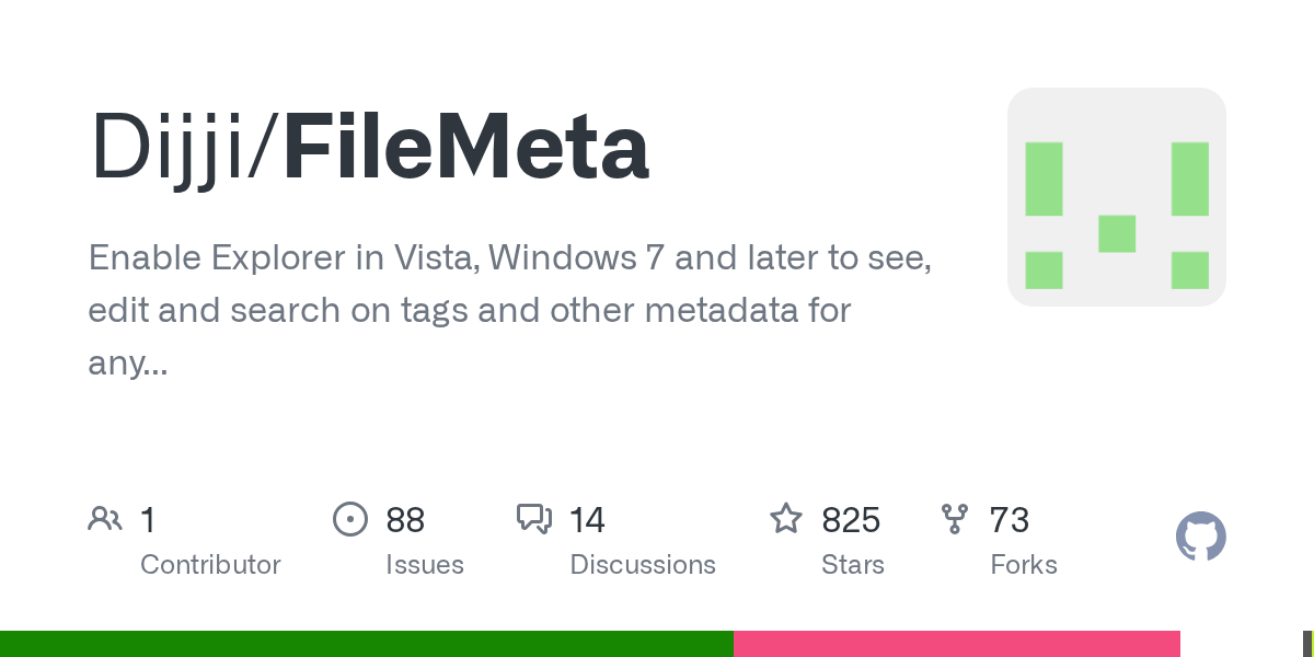

For the archives issue have you come across File Association Manager before?
I’ve heard good things, that it can register unsupported metadata file types with the windows properties table. I haven’t tried it yet though.
