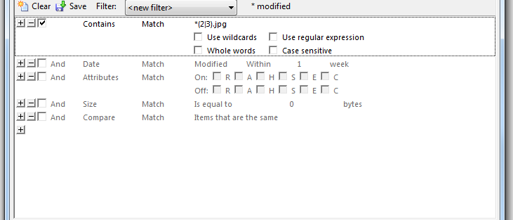

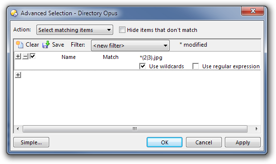

Please post a screenshot of the Select-Advanced dialog just before you push return or click OK. The dialog must have some kind of action and filter configured in it (not just a wildcard string) and the exact details matter.
For example:
Hi,
enclosed is the screenshot. on the 4100 files (win7x64) it runs for 10 minutes but eventually comes back. Is that normal ?

That filter is actually searching the contents (via the Contains clause) of the files, not the filenames - so Opus has to search through the entire content of every file. If you want to search filenames, use the Name clause.
ahh my bad, thank you

got it, i guess. * .jpg works
You're using wildcards rather than regular expressions. (There is some overlap but the syntaxes are very different in places so it's best not to confuse the two. Opus supports both.)
FWIW, you should not need the [ or ] (although it's probably harmless). Just * (2|3).jpg should be enough.
