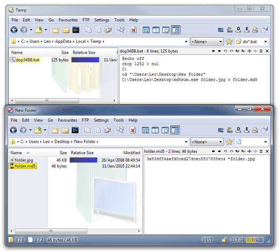

I got md5sum from here and tried it in an MS-DOS button. Seems to work fine.

Have a dig in your temp folder and see if you can find the .bat file Opus is generating for the button. (It should stay around for a minute or two after the button is run before Opus cleans it up.)

Corruption (for the first file only if I select mutiple files) is caused by the
chcp 1250 > nul
line in .bat file.
When I run the file created by DO from the command line, I get the same problem. When I REM the line, problem goes away.

Try adding one of these lines to the top of the button's command:
@codepage 850
Or
@codepage 1250
Or open a command prompt and type chcp on its own to see what your machine's default codepage for DOS is.
I still can't reproduce the problem on my machine, even when using 1250, but it could be something that's fixed in Windows after XP, or maybe I've got a different version of md5sum.exe.
The DOS codepage does define which codepage is used to redirect program output into text files, so it's certainly involved here, but I can't think of any (sane) reason why it would result in a large amount of garbage being inserted into the file. That seems like a bug somewhere, and not in Opus since you've seen it happen when just running the .bat file. Strange!
Adding @codepage 852 (my default cp) solved the problem.
It must be some OS language-specific problem.
Anyway, default codepage written in DO batch could be the system's default cp, not the 1250 one.
It does use the system's default codepage; and since 1250 is ANSI Central European; Central European (Windows) this would seem to be correct for Poland?
It uses the codepage of the dopus.exe process but for some reason that seems different from the codepage used by default in a command prompt (1252 vs 850 for me and 1250 vs 852 for Xyzzy).
Not sure what the 'right' thing to do is, though. Aside from this issue (which is surely a bug in something other than Opus), using a codepage consistent with dopus.exe means the filenames it puts in the .bat file are more likely to work correctly without translation issues, I would've thought. I don't understand why the command prompt and UI programs are getting different codepages though... Perhaps there's a reason.
