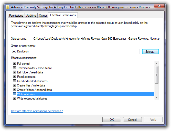

It's possible those folders are permissioned in a way which doesn't allow your account (even with admin rights enabled via UAC) to change their attributes.
You can see if this is the case by opening the Properties dialog for one of the problem folders, clicking on the Security tab, then the Advanced button, and then on the Effective Permissions tab.
Then click Select and type in your account name, and see if "Write attributes" is ticked.
