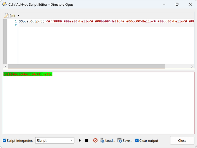

Starting the tag with a single # seems to work as well:
DOpus.Output('<#ff0000 #00aa00>Hello<# #00bb00>Hello<# #00cc00>Hello<# #00dd00>Hello<# #00ff00>Hello')
