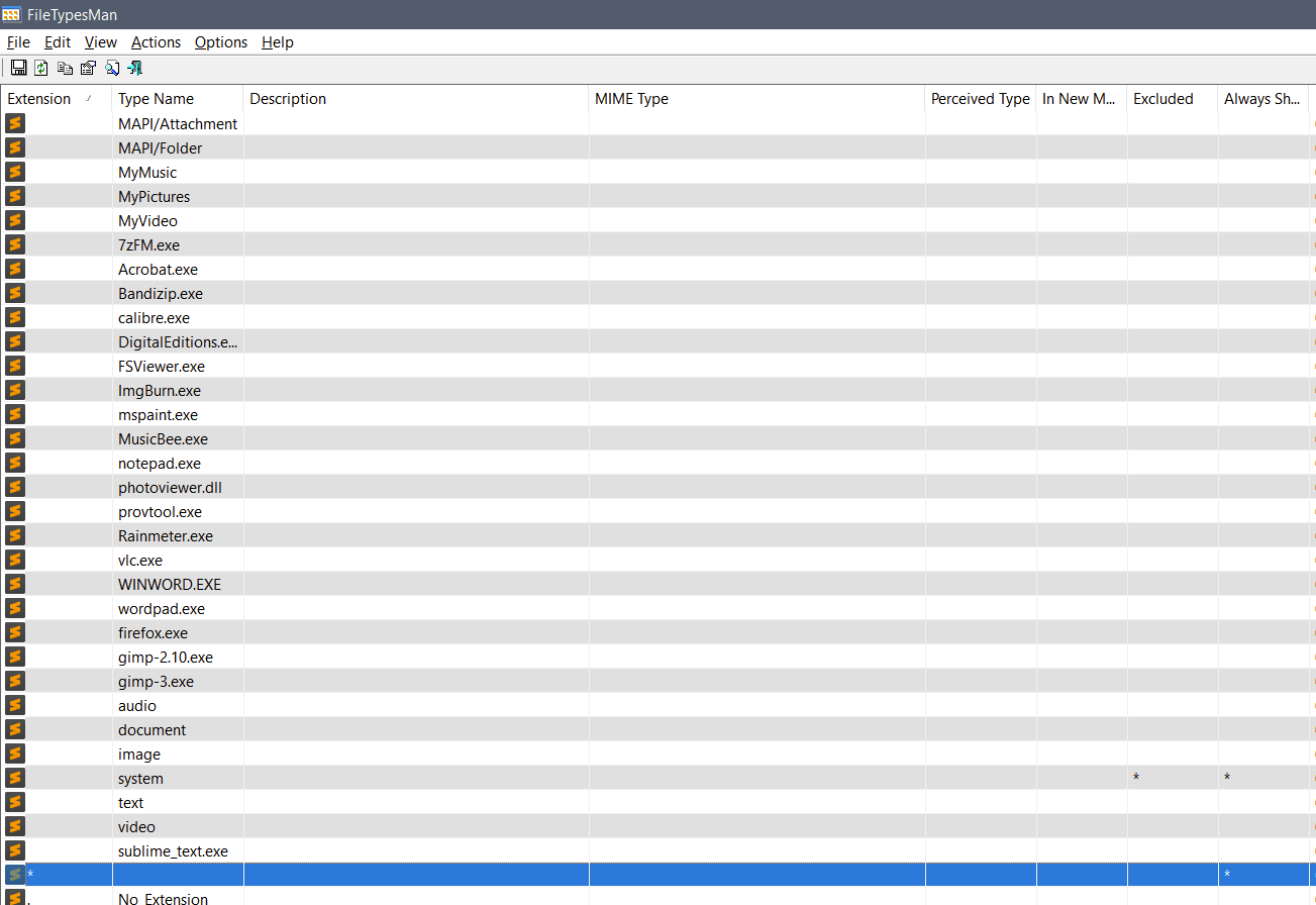

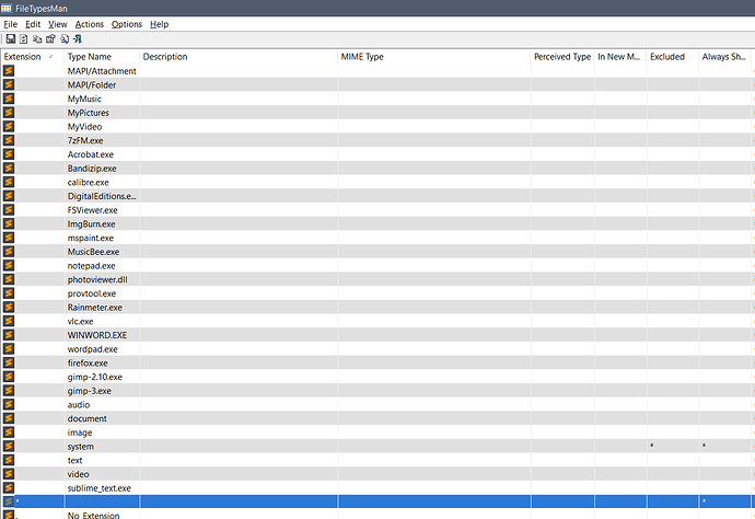

   The (partial) solution is as follows. Obtain NirSoft’s program ‘FileTypesMan[ager]’. Within that program, locate the item, very near the start of the items that the program lists, with these characteristics:
      Extension .
      Type Name No_Extension
      And the item has a Sublime icon.
Then use FileTypesMan to ‘disable’ that item.
I spoke too soon. Now - after a reboot, and after opening an extensionless file with Sublime - the problem has reappeared.
EDIT: or rather I seem not to have the problem for shortcuts-to-directories. Perhaps things are rather messed up on my system. For, I see the following - which I cannot edit with FileTypesMan and which I do not really understand.

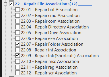

So/but I tried the following within the program called ‘Windows Repair’:
The program prompted me to reboot; I have not yet done that.
