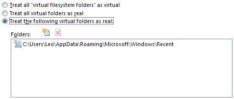

Click the Add icon above the list (there are only two, add and delete; hover over them to get tooltips if you're not sure which is which), then select Desktop and click OK.

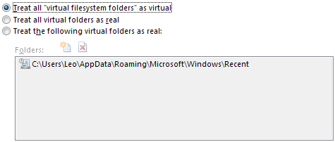

Ok. By default, I certainly didn't change anything there, I had "Treat all 'virtual system folders' as virtual.
In that case, there is no "Add icon" option.
To get that, you have to go for "Treat the following virtual folders as real:"
Correct?
If you tell Opus to treat all virtual folders as virtual, or all virtual folders as real, then the list of folders to treat otherwise is disabled. You've told it to treat them all the same, rather than selected the option which only treats particular folders differently...
Note the other visual cues:
[ul][li] The third option's label referring to "the following virtual folders" (which could only mean the list below it, which none of the others refer to).[/li]
[li] The ':' on the end of the third option and not the others.[/li]
[li] The list and associated buttons/labels being indented below the third option.[/li]
[li] The list and associated buttons/labels being disabled (gray/ghosted) unless the third option is selected.[/li]
[li] The three options being mutually exclusive, both in terms of their described actions and them being a group of radio buttons (i.e. circles instead of square checkboxes) where only one of the three can be selected at a time.[/li][/ul]
