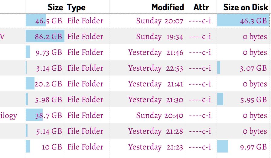

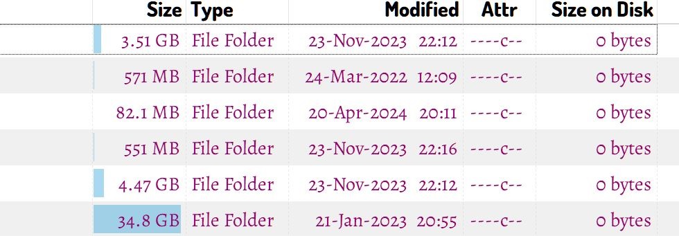

I was experimenting with NTFS compression and taking a look at the Size on Disk column in DOpus to see if any space was actually saved.
Its output is strange. Often it says 0 bytes, but if I ask it to recalculate it may give the correct size, or zero again. If it gives the correct size, recalculating again may gave 0 bytes again.

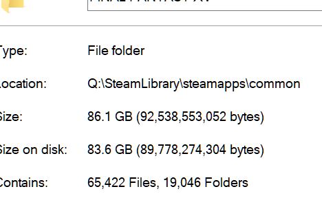

There seems no discernible pattern to it - while some directories are never miscalculated, some always are, but this is not affected by subdirectory or file layout or by compression efficiency. It happens with and without Everything selected in the preferences. Below you can see that Windows doesn't seem to have any issue sizing the directory itself.
Capture2

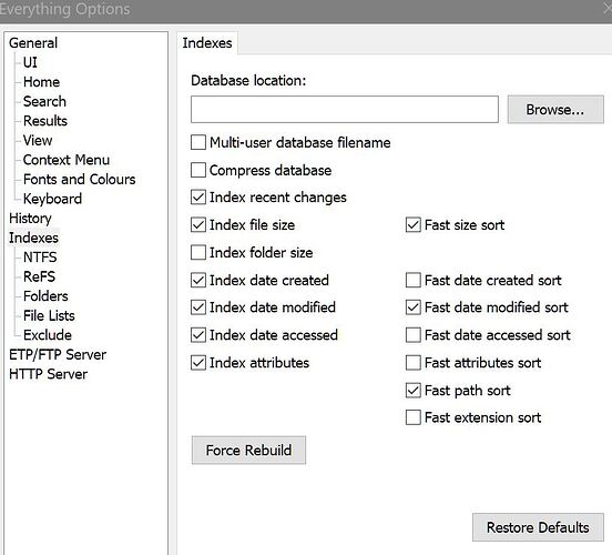

I had set up everything according to the the example I was given here. Index folder size is unchecked; not sure why but this was what was recommended.
Do you recommend that I switch index folder size on?
Yes, follow the text. The image is only really there to show what Everything's settings UI looks like and hasn't been updated since we added that recommendation to the text.

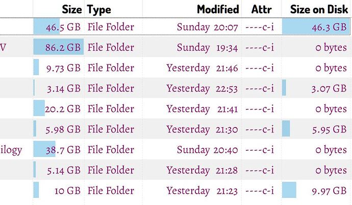

Ok. Doesn't seem to have made any difference though - still getting a 0 bytes when Everything is on.

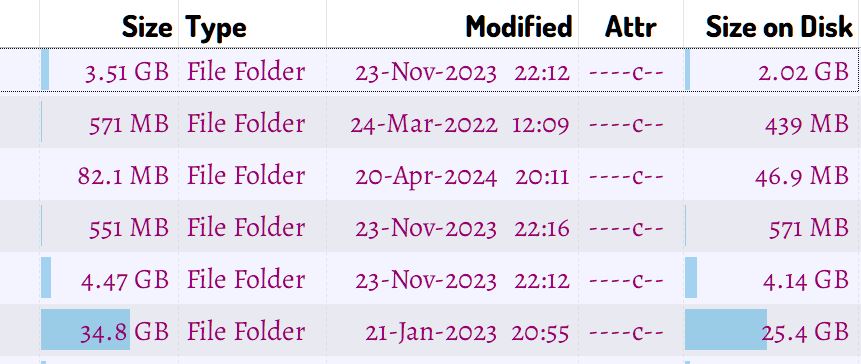

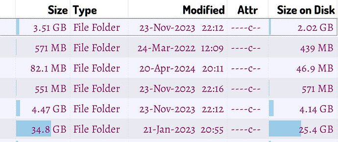

When it is off...
Everything, searching from it directly, doesn't appear to care if the folders are compressed or not, it just reports the size of the directory as it would be if it had no compression.
Looking at this again, the image is fine and matches the text.
It's Index FILE size that needs to be on, not Index Folder Size.

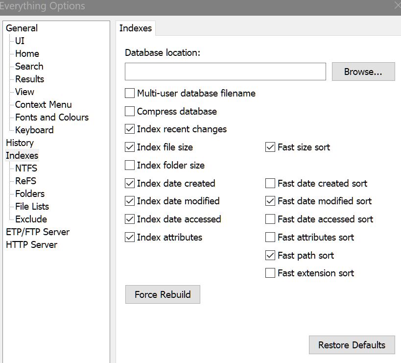

Regarding the main issue, please try opening Everything and then asking it to rebuild its index. (Everything Options, Indexes, Force Rebuild.) That has helped people with folder-size issues in the past, at least.
