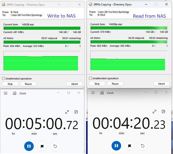

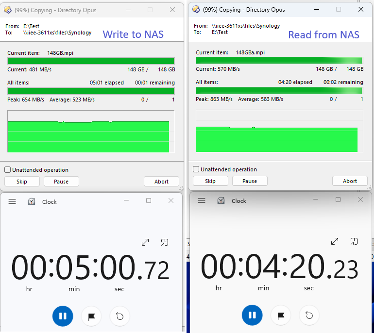

Below is the speed test for my old Synology DS3611xs NAS. In average, DOPus is doing 523MB/s upload and 583MB/s download.

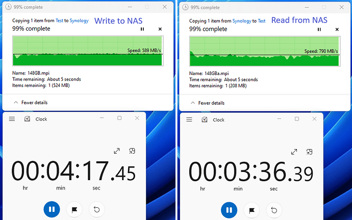

Windows File Explorer result below is faster with about 589MB/s upload and 790MB/s download. Time difference is about 40s for both.

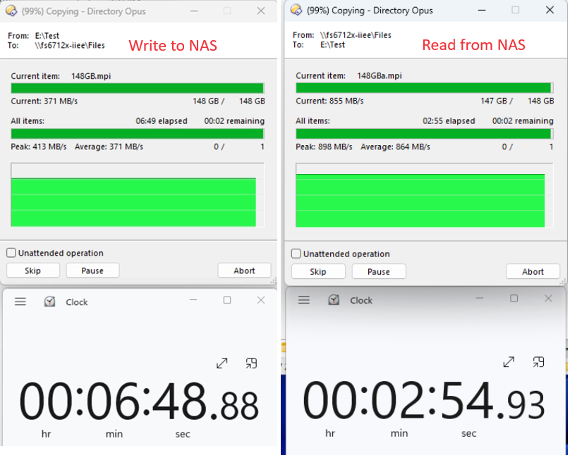

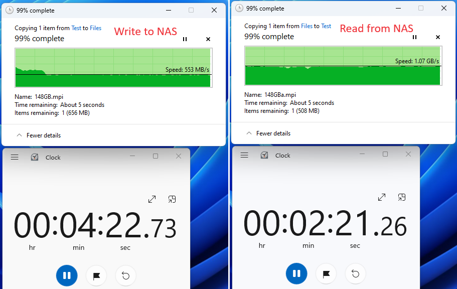

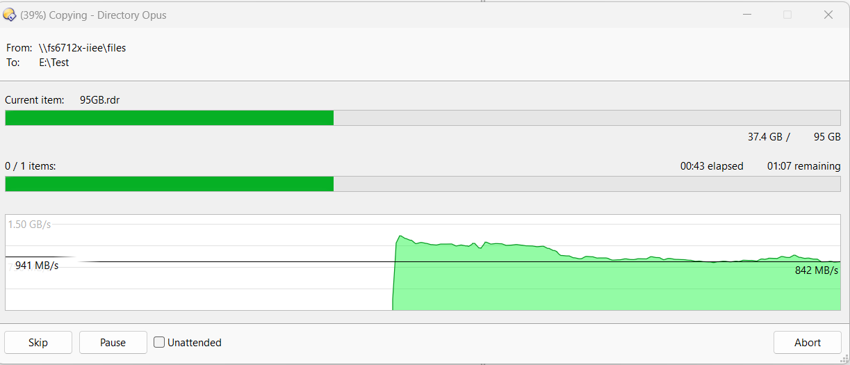

Next, another speed test is carried out for Asustor FS6712X all flash NAS as below. DOpus is doing 371MB/s upload and 864MB/s download.
Windows File Explorer below is again faster with about 550MB/s upload and 1000MB/s download. The higher write speed at initial stage (800MB/s) cannot sustain because of the cheap dram-less ssd i used in the NAS. However, this burst speed did not happen with DOpus, it was constant at ~370 from the start. Time difference is bigger with this NAS write.

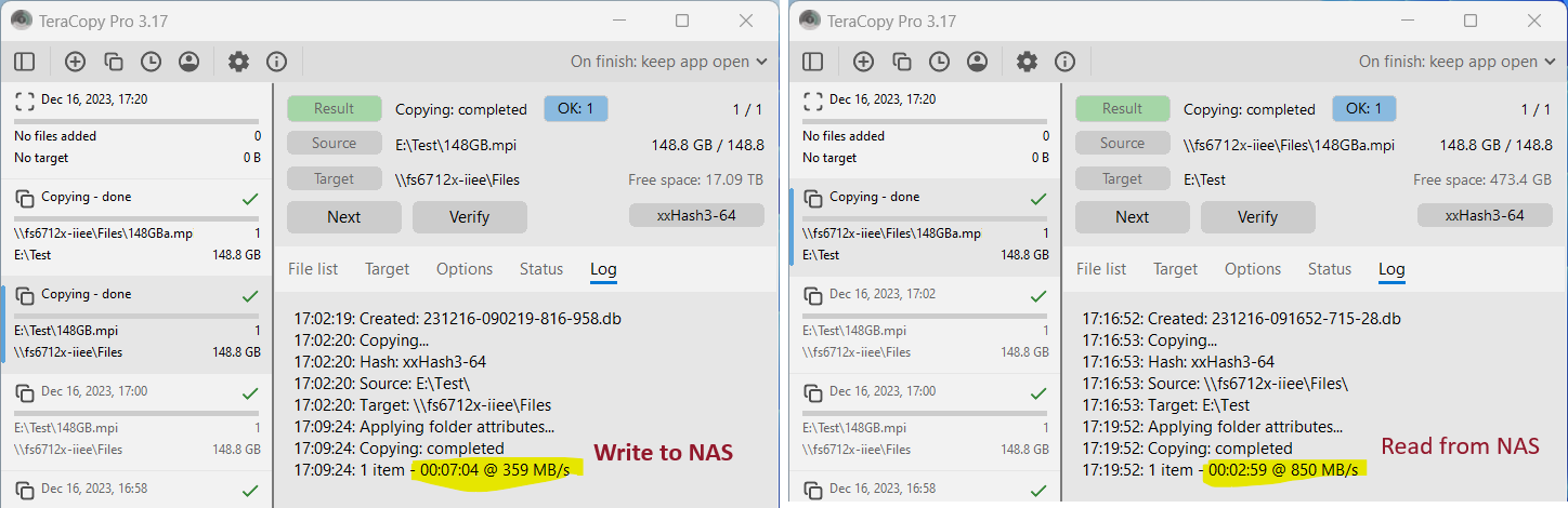

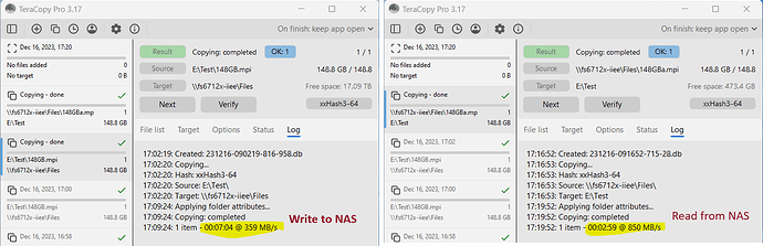

TeraCopy Pro demonstrated similar read/write result as DOPus (default 1MB buffer size) regardless it is used within DOPus or thru File Explorer. I attached only Asustor result here.
Since TeraCopy is also unable to help in this situation, is there anything else that can be done for the time being until the next release with CopyFileEx?

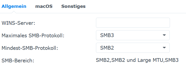

the speed of synology devices is higher with the do 13 than with the do12.
However, the current DSM version is required: 7.2.1-69057 Update 3
29 dsm versions difference to your current one
they have changed the protocol several times since 7.x
check
changing the copy buffer and copy non buffer defaults partially worsens the whole thing
check with default
your hardware can only handle max DSM version: 6.2.4-25556 Update 7

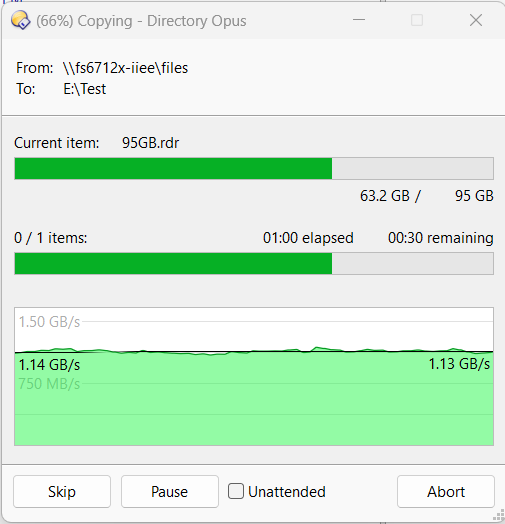

Just installed OPus 13 beta, and yeah the network transfer speed is now similar to windows explorer. Finally something hang on for so long has a solution.
Opus 13 did solve this network transfer speed problem and tested in the fresh windows 11 installation copy. However on earlier windows 11 with Opus 13 (same laptop, just different windows SSD), the transfer speed will not reach the same level of fresh windows copy (even using file explorer). It can only achieve 85-90% speed of fresh windows. network Speed test was done on 2nd, 3rd, 4th & 5th ssd inside the laptop and not the windows ssd. The laptop can house 5 ssd.
