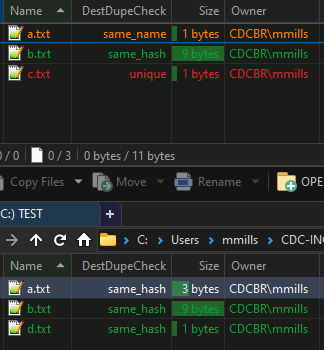

Opus 13.18.7 and later give script columns expanded access to both the source and destination. This allows labels to be assigned according to Filter values, which are determined by the results returned from script columns.
The example below shows a script column that compares files in the source with those in the destination, returning either unique, same_name, or same_hash.
In Preferences / Labels / Label Assignments, these three filter labels can be configured to display as red, orange, or green, depending on the script column’s output.
The script column can also be used in a Find filter. Note that the script looks for files directly in the destination and won't dive into subfolders, so be careful when checking Search subfolders.
Wow, thank you for this excellent script and setup workflow @lxp! I am however having an issue with the ColumnnDestDupeCheck.js you provided.
It seems to always identify files in the destination lister as "same_hash". The Active lister identifies files correctly. Not sure what may be causing it to do this as your screenshot clearly shows it working.
I am using Dopus 13.19
See screenshot below where I replicated your example, top lister is the Active lister:
Edit:
After some experimenting - I believe there is nothing wrong with the script per se, but it is an issue with the destination tab not refreshing when the script is run or when folders change
Missing or delayed refreshes/hash calculations (potentially caused by the cloud storage) are the only explanation I can think of at the moment. I haven't been able to reproduce it otherwise.
