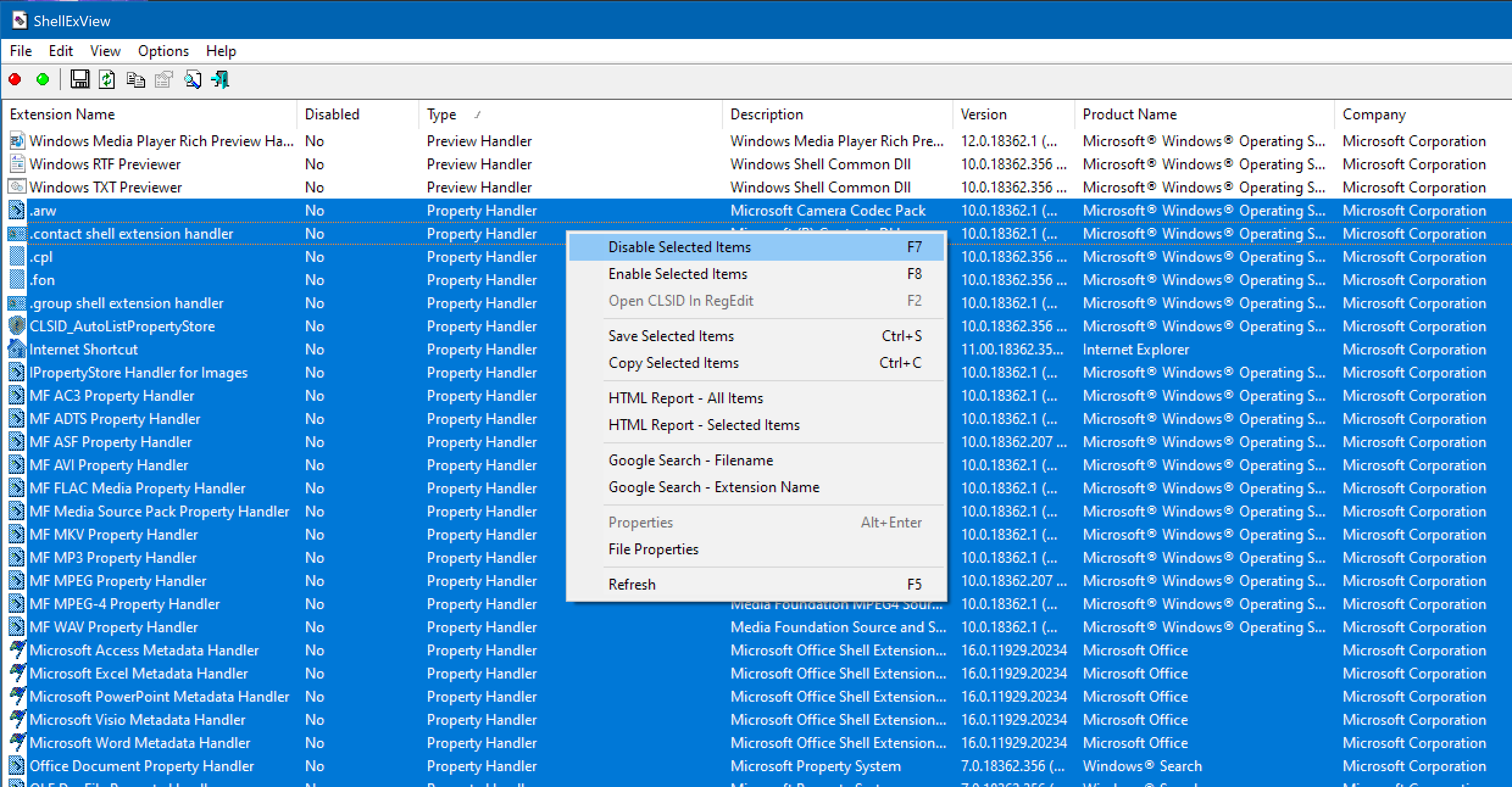

  • Grab ShellExView (get the x64 version, near the bottom of the page).
  • Sort by the Type column.
  • Scroll down to the Property Handler extensions to see which are installed.
  • Do any look related to PDF software?
  • If so, right-click them and chose the Disable option. Reboot. See if the problem is still there.
  • To re-enable them, do the same but choose the Enable option instead.
Screenshot for illustration, although I don't recommend disabling everything, just anything with Type = Property Handler that looks PDF-related or possibly not part of Windows/Office (of which I don't have any examples shown/installed).
Also be careful not to select any Preview Handler items, as the two names look very similar.
