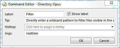

If you add the File Filter Field to a toolbar and give it the argument realtime, you can filter your display as you type in that box.

Hi John,
I have DOPUS 9.5.6 (running under XP) and my screenshot is different to yours:
I am new to customising DOPUS so could you please explain to a newbie how to implement your suggestion?

dluby, see the FAQ: How to add and configure filter boxes.
