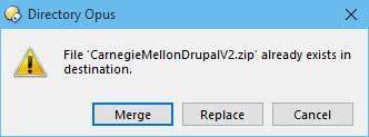

I am creating a script that uses a command that will create an archive something likecmm.RunCommand ("Copy HERE ARCHIVE=.zip CREATEFOLDER=" + zipName(subject))When an archive exists already with same name it gives the options in the picture. I have created a script that uses the option for a dialog (one I created) with the results property being a way to use its returned value e.g.if (savePath.result) {
}How do you use a default Opus generated messages' “results” property or returned value in your own script?
I'm not sure what the question is asking. There are lots of ways to use the results property. What is it that you want to do with it?
Please also start a new thread for separate questions (see the one question per thread link at the bottom of the FAQs for reasons).
