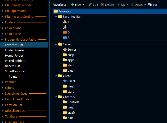

I will try to give you my example!!!
Start defining the groups you need inside the Favorites List
I have one common "Favorites Bar", Then I have 3 Projects: Server, Client, Controls. Create at least one item in each category so you understand what you are seeing...

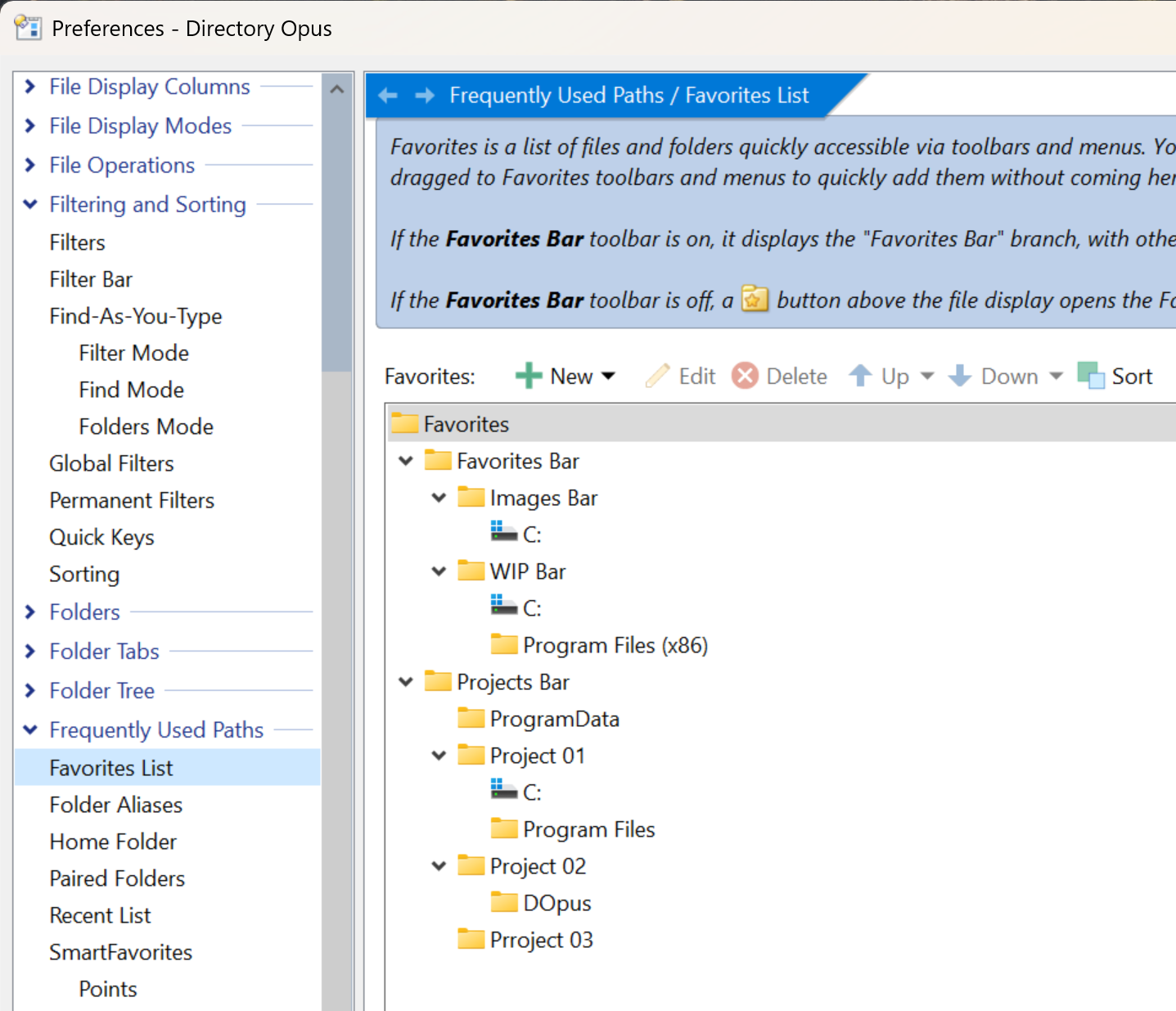

By default, Favorites under Preferences / Frequently Used Paths / Favorites List has a single entry, labeled "Favorites Bar." Any number of items can be created at this top level, labeled anything at all.
Any number of branch items can be nested under any top level item. The contents of a top level displays horizontally while a branch's contents displays vertically.
Lastly, any number of Favorites that point to an actual folder or file in the file system can be under either a top level item or a branch item. If you have a lot of Favorites put them in a branch.
Visually, it can sometime be difficult to see the difference between a branch and a favorite when they are at the same level. In the screenshot below, under the Projects Bar, ProgramData is a favorite while Project 03 is a branch.

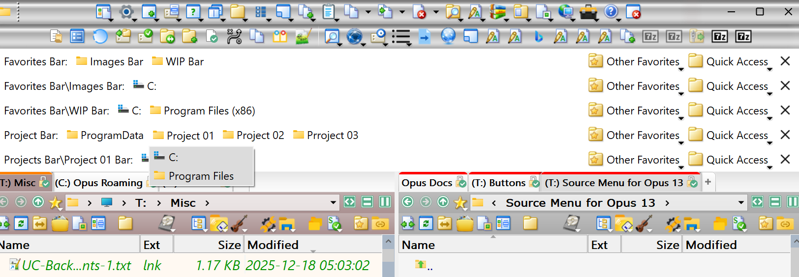

In the screenshot below, the Favorites Bar and Projects Bar are at the same level, the top level. The Favorites Bar has two branches under it, the Images Bar with one favorite under it and the Work in Progress Bar with two favorites under it. The Project Bar has one favorite and three branches under it.
Any top level or branch can be accessed from a toolbar with a special button on it. Most often, either all top level items would be accessible each from its own toolbar and button, or all branches would be accessible each from its own toolbar and button. Workflow determines how you want to divide up Favorites. The least complicated structure is a single top level with only favorites under it. The next complicated would be a single top level with multiple branches with multiple favorites. The most complicated would be multiple top levels each with multiple branches with multiple favorites as shown in the screenshot.

  1. From Preferences / Frequently Used Paths / Favorites List, select Favorites, right click and select New Branch for each top level item.
  2. Select a top level item, right click and select New Branch for each branch under that top level.
  3. Create a toolbar from Customize / Toolbar usually named after the top level or the branch from Favorites
  4. Create the special button for each toolbar
    4.a. For a top level, the code is: Favorites KEYARGS Multifunc Shift:NEWTAB SHOWICONS USEQUALKEYS NOOPENINTABS AUTOCREATE BRANCH="???" where ??? is the name of the top level
    4.b. For a branch, the code is: Favorites NOLABELS SHOWICONS USEQUALKEYS NOOPENINTABS AUTOCREATE BRANCH="??????" where ?????? is the top level name\branch name.
  5. Create a button to display the toolbar. When this button displays the toolbar, Favorites can be dropped on it.
In practice, you wouldn't show all these Bars at the same time. The Project 01 branch is open.

Button calling a top level toolbar
Projects Bar Toggle.dcf (1.1 KB)
@toggle:disable
Toolbar NAME="-FB Projects Bar JEG" STATE=top LINE 15 TOGGLE
Button calling a branch toolbar
Projects Bar_Project 01 Toggle.dcf (1.1 KB)
@toggle:disable
Toolbar NAME="-FB Projects Bar Project 01 JEG" STATE=top LINE 15 TOGGLE
Hope this is instructive.
Thank you @johntor! I’ve been banging my head against this for quite some time and would never have figured it out without your walkthrough.
This is a great feature multiplying toolbar space. Now you may show the group of buttons depending on your current workflow, which is great.
Many thanks to the Opus Team that provide us with great tools...
J!
