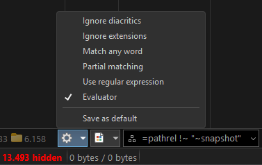

I’m still facing the issue I described above.
In short, here’s what I do to reproduce it:
1. I open a folder in flat view (Set FLATVIEW=On,Grouped)
2. I use the filter bar as such and press Enter:
3. All files and folders are hidden, which is incorrect.
4. I need to toggle the Evaluator checkbox off and on again to make the filter work correctly.
Btw, shouldn’t enabling the Evaluator checkbox disable all other options? Does it make sense to “Use regular expression” together with Evaluator=On?
Have you turned on filtering of folders in flat view? If so, the filter will hide anything that has any ancestor folder that doesn’t match the filter. (This is why it’s off by default.)
If it’s not that, I would start with a more simple case to see if that works, e.g. just match *.jpg and not involve evaluatior code
Try path instead of pathrel as well, since pathrel raises the question of what the filter is relative to.
The “Filter folders in flat view” option is off in all my examples.
I just experience a very weird an inconsistent behavior of the filter bar when in flat mode and evaluator enabled. Often it filters (hides) all files, which is incorrect. Often I need to switch evaluator off and on again to make it work.
I can try to prepare a folder/file structure that I upload in a ZIP file for testing. But it seems to show that behavior regardless of a particular structure, so you should be able to reproduce it.

The options are still available because their state is passed through to an evaluation filter as flags (e.g. opt_partial gives you the state of the partial match option). This gives evaluation filters the chance to modify their behavior depending on the state of the other flags.
That makes sense. What I meant was more that maybe DOpus should set regex=off, partial=off etc. the moment the evaluator is enabled. At least I don’t know what regex=on would do when evaluator=on.
Please also have a look at the weird behavior of the filter bar when using the evaluator, as I described in my previous posts.
It sets the opt_regex evaluator variable to true, which the evaluator filter can use for whatever purpose makes sense for that filter.
