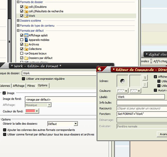

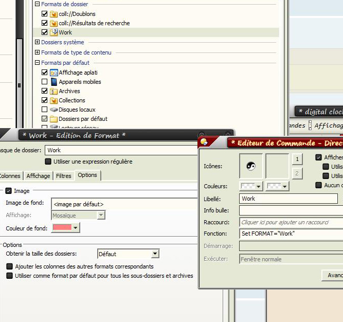

I forgot to add the picture of what I did (for the use of the command Set FORMAT
If something is wrong in it, feel free to point it to me
Thanks
You've created a wildcard format called Work there (at the top of the list in Preferences). I said to create a Favorite format (at the bottom of the list).
