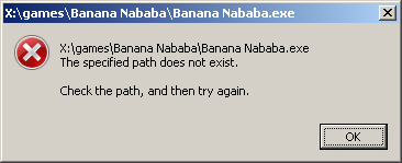

There's a file - T:X/Games/BananaNababa/BananaNababa.exe. Now I run a "Subst X: T:\X" and in the Folder Tree a new drive letter will appear (X:). Clicking on it shows a folder "Games" in the lister's tab. A few more clicks and I end up in the directory where the "BananaNababa.exe" (and some other files) is. So far so good. But, doubleclicking on the "BananaNababa.exe" just returns a standard "file doesn't exist" kind of message.
Now back in the folder tree, clicking on "T:" drive and all the way down to "BananaNababa.exe" runs the game without problems... No error messages whatsoever.
Same kind of problem appears with ProcessMonitor for example. Other files can't be copied, or moved etc. I also can't change owners / permissions of the files ("The system can not find the path specified"). I can change the owners / permissions but they do not get saved properly if this means anything.
I have only one external drive that I map all the letters to, haven't tried with other drives.
First the UAC window appears ("Do you want to allow the following program to make changes to your computer?" - can't screenshot it because Alt-PrtScreen stops working when the message appears), and then a standard sounding "can't find" message (attached).
